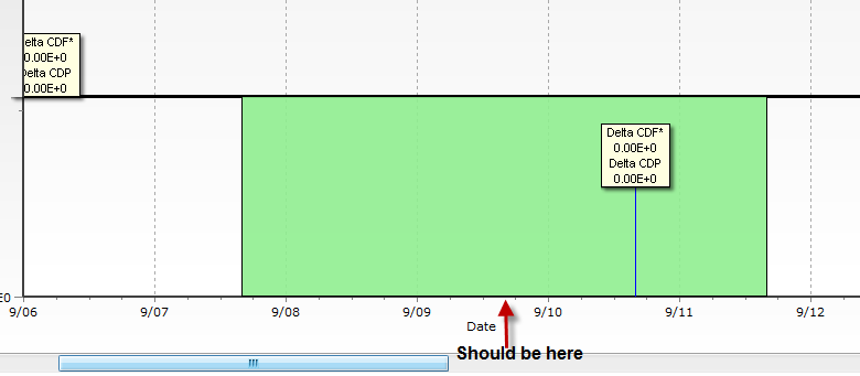

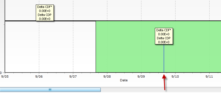

I have added some MarkText to series marks, and all works well unless the user moves the text boxes and also moves the scroll bar.
If the user moves the MarkText and then scrolls, the MarkText stays in the same screen position, and does not move with the rest of the cart. This happens for all unmoved MarkText items after the one moved, but any unmoved ones before it work fine. Once you scroll to where the item would no longer be visible, then it just disappears.
I was using 8.06 but upgraded to version 8.08 and the problem still exists.
See Attached Pictures.

Post by Yeray » Tue Mar 10, 2015 4:15 pm
Take a look at this reply.
I've made a simple example using a TBarSeries:
uses Series, Types;
var XOffset, YOffset: Array of Integer;
    MouseDownPos: TPoint;
var s, i: Integer;
  Chart1.Legend.Visible:=false;
  Chart1.View3D:=false;
  with Chart1.AddSeries(TBarSeries) do
    FillSampleValues;
    Marks.Arrow.Color:=clRed;
  SetLength(XOffset, Chart1[0].Count);
  SetLength(YOffset, Chart1[0].Count);
  for i:=0 to High(XOffset) do
    XOffset[i]:=0;
    YOffset[i]:=0;
  with Chart1.Tools.Add(TDragMarksTool) as TDragMarksTool do
    Series:=Chart1[0];
    OnDraggedMark:=DragMarksOnDragged;
procedure TForm1.DragMarksOnDragged(Sender:TDragMarksTool; Index:Integer;
                                    Button:TMouseButton; Shift: TShiftState;
                                    X,Y: Integer);
  if Assigned(Sender.Series) then
    if (Index>-1) and (Index<Length(XOffset)) then
      XOffset[Index]:=XOffset[Index]+X-MouseDownPos.X;
      YOffset[Index]:=YOffset[Index]+Y-MouseDownPos.Y;
procedure TForm1.PlaceMarks;
var s, i, tmpSize, tmpX, tmpY: Integer;
  Chart1.Draw;
  for s:=0 to Chart1.SeriesCount-1 do
    if Chart1[s] is TBarSeries then
      with Chart1[s] as TBarSeries do
        for i:=0 to Count-1 do
          with Marks.Positions[i] do
            tmpX:=CalcXPos(i);
            tmpY:=CalcYPos(i);
            Custom:=true;
            LeftTop.X:=tmpX + BarWidth div 2 - Marks.Item[i].Width div 2 + XOffset[i];
            if MarksOnBar then
              if MarksLocation=mlEnd then
                LeftTop.Y:=tmpY
                tmpSize:=CalcYSizeValue(YValue[i]);
                if MarksLocation=mlStart then
                  LeftTop.Y:=tmpY+tmpSize-Marks.Height
                  LeftTop.Y:=tmpY+(tmpSize div 2)-(Marks.Height div 2);
              end
              LeftTop.Y:=tmpY-Marks.ArrowLength-Marks.Height;
            LeftTop.Y:=LeftTop.Y+YOffset[i];
            ArrowFrom:=Point(tmpX+BarWidth div 2, tmpY);
            ArrowTo:=Point(LeftTop.X+Marks.Item[i].Width div 2, LeftTop.Y);
procedure TForm1.Chart1Scroll(Sender: TObject);
  PlaceMarks;
procedure TForm1.Chart1Zoom(Sender: TObject);
  PlaceMarks;
procedure TForm1.Chart1UndoZoom(Sender: TObject);
  PlaceMarks;
procedure TForm1.Chart1MouseDown(Sender: TObject; Button: TMouseButton;
  Shift: TShiftState; X, Y: Integer);
  MouseDownPos.X:=X;
  MouseDownPos.Y:=Y;
