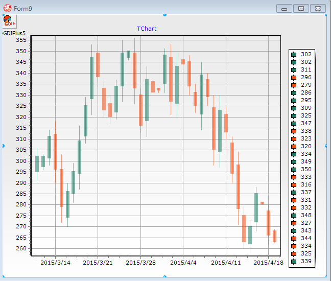

I'm trying to enable transparency property of OHLC,
but seeing unexpected Hi-Low line reveal in the center of candle. (pic. attached)
How can I keep a "plain transparency" without seeing the middle part of the line in the candle body?
I'm a source user, please advice if source modification is required. Thanks!

I'm afraid in this case you should draw the lines manually. Ie:
uses Math;
var Series1: TCandleSeries;
  Chart1.View3D:=false;
  Chart1.Legend.Visible:=false;
  Series1:=Chart1.AddSeries(TCandleSeries) as TCandleSeries;
  Series1.UpCloseColor:=RGB(29, 123, 99);
  Series1.FillSampleValues();
  Series1.HighLowPen.Visible:=false;
  Series1.HighLowColor:=cbSameAsCandle;
  Series1.Transparency:=50;
  Series1.OnGetPointerStyle:=Series1GetPointerStyle;
function TForm1.Series1GetPointerStyle(Sender: TChartSeries;
  ValueIndex: Integer): TSeriesPointerStyle;
var tmpX, tmpOpen, tmpClose, tmpHigh, tmpLow: Integer;
  procedure drawLine(FromY: Integer);
  var ToY: Integer;
    ToY:=Min(tmpOpen, tmpClose);
    if (FromY<ToY) then
      if Sender.ParentChart.View3D then
        Sender.ParentChart.Canvas.VertLine3D(tmpX,FromY,ToY,Sender.MiddleZ)
        Sender.ParentChart.Canvas.DoVertLine(tmpX,FromY,ToY);
    end
      ToY:=Max(tmpOpen, tmpClose);
      if (FromY>ToY) then
  if (Sender is TCandleSeries) and (ValueIndex>-1) and (ValueIndex<Sender.Count) then
    with (Sender as TCandleSeries) do
      tmpX:=CalcXPos(ValueIndex);
      tmpOpen:=CalcYPosValue(OpenValues[ValueIndex]);
      tmpClose:=CalcYPosValue(CloseValues[ValueIndex]);
      tmpHigh:=CalcYPosValue(HighValues[ValueIndex]);
      tmpLow:=CalcYPosValue(LowValues[ValueIndex]);
      if HighLowColor=cbUseColor then
        if HighLowPen.Color=clTeeColor then
          Chart1.Canvas.Pen.Color:=Pen.Color
          Chart1.Canvas.Pen.Color:=HighLowPen.Color
        if tmpOpen<tmpClose then
          Chart1.Canvas.Pen.Color:=DownCloseColor
          Chart1.Canvas.Pen.Color:=UpCloseColor;
      drawLine(tmpHigh);
      drawLine(tmpLow);
