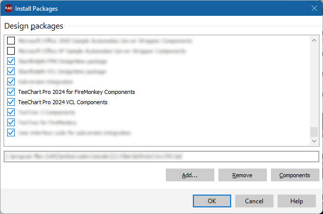

Here there are some instructions to make sure the packages and the paths loaded in the IDE are correct:
  1. Open the IDE with no project loaded.
  2. From RAD XE2, make sure you have "VCLTee" (for VCL projects) or "FMXTee" (for FMX projects) in the unit scope names.
  3. Go to "Component/Install Packages...". In this list, check the TeeChart Pro components are selected and not the Lite/Standard version that were shipped with the IDE.
