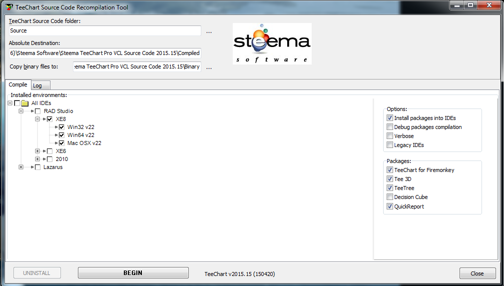

1. I ran TeeCompile.exe and checked Delphi XE6 and XE8. Installation went just fine.
Here are settings
My settings for installation

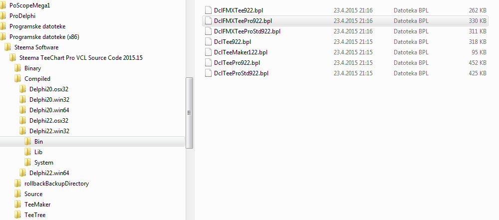

and my folder structure
My folder structure

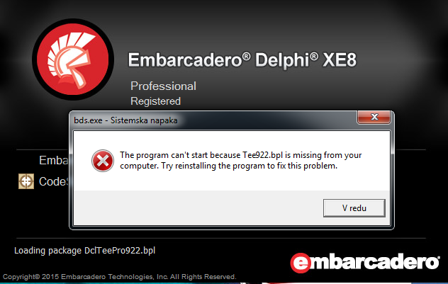

2. When I run delphi xe8 I get error messages:
Error message 1
and it asks me if I would like to load it next time or not (classic).
3. If I try to install them manually from Delphi menu "Install packages" it says it cannot find selected file (eventhough I selected it!?!)

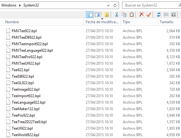

It may be due to a lack of writing rights at "C:\Windows\System32" and "C:\Windows\SysWOW64".
Try moving the according files manually:
  • In a 64bit Windows:
    • *.bpl from "\Compiled\Delphi22.win32\System\" to "C:\Windows\SysWOW64"
    • *.bpl from "\Compiled\Delphi22.win64\System\" to "C:\Windows\System32"
  • - In a 32bit Windows:
    • *.bpl from "\Compiled\Delphi22.win32\System\" to "C:\Windows\System32"
Now try to reopen the IDE.

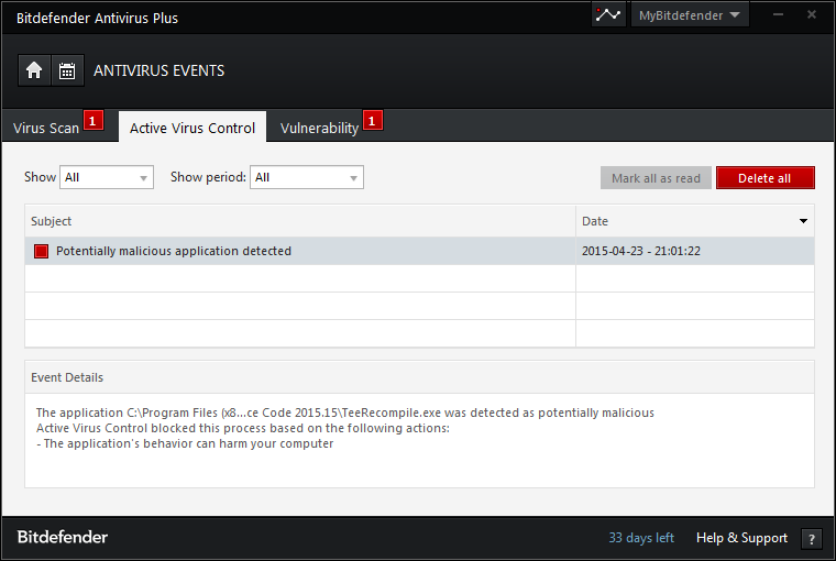

thanks. I checked out several things, including my BitDefender antivir sw. It reports that TeeCompile might be potentionally dangerous.
BitDefender
Anyways I put TeeCompile on my whitelist and now it seems fine.

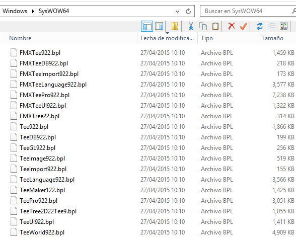

Next thing I checked was folders System32 and SysWOW64 and you was right. There were bpl files in System32 but not in SysWOW64. I checked out security rights and for both folders are same so this should not be an issue.

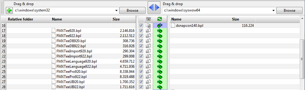

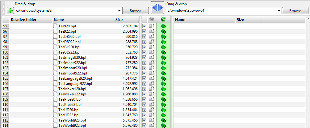

I opened both folders at same time and re-ran TeeCompile.exe and started installation for XE8 and XE6 and I notice that bpls are automatically copied to System32 only(after folder content compare)
Files only in system32
Files ony in system32
It seem TeeCompile.exe doesn't copy files to SysWOW64. Is this problem on my side? Can you confirm that you really copy files to SysWOW64?
After that I manually copied bpls to SysWOW64 everything works fine.

PoLabs wrote:It seem TeeCompile.exe doesn't copy files to SysWOW64. Is this problem on my side? Can you confirm that you really copy files to SysWOW64?
I've re-checked it running TeeRecompile against several IDEs and I can confirm it always copies the necessary files to both System32 and SysWOW64.
PoLabs wrote:After that I manually copied bpls to SysWOW64 everything works fine.
I'm glad to hear you could make it work.
