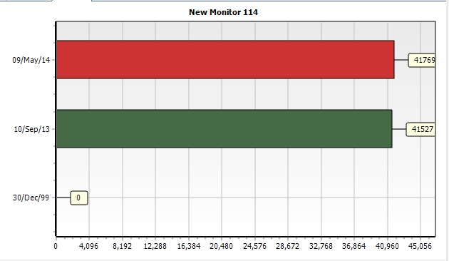

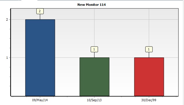

I have come accross a strange issue and not sure how to proceed. When I run the same code for all other charts the data looks ok except for the horizontal chart where the values come out being very high. I have attached two charts the vertical is the correct data that is being passed from the datasource but the horizontal one is coming out with values like 41,527.
This seems to be occuring because I am setting the ChartSeries.XValues.ValueSource := '#SUM#' + FieldName on a Horizontal barchart. However, It seems to work when I set ChartSeries.YValues.ValueSource := '#SUM#' + FieldName for a vertical bar chart. This logic worked on the version 8 TeeChart so I was wondering if there is something I need to do for the new version of the TeeChart
Horizontal Barchart giving high values
- Wrong Data
- Horizontal.jpg (37.71 KiB) Viewed 13754 times
- Correct Data
- Vertical.jpg (25.79 KiB) Viewed 13724 times

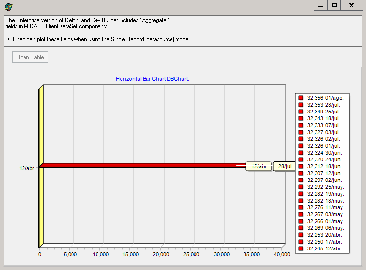

I have modified the DB project you included in the example to show the error with the horizontal chart. When you change the series to a Barchart, the numbers are correct. The project was modified using Delphi XE6
- DBChart Aggregates.zip
- (6.91 KiB) Downloaded 888 times
Re: Horizontal Barchart giving high values
I had to change the Database name from "DBDEMOS" to "TeeChart Pro Database", clear and add all the fields on the table and to run the example here.
So I want to check I'm getting the same result than you:
yes, thats correct. That was what I was getting
