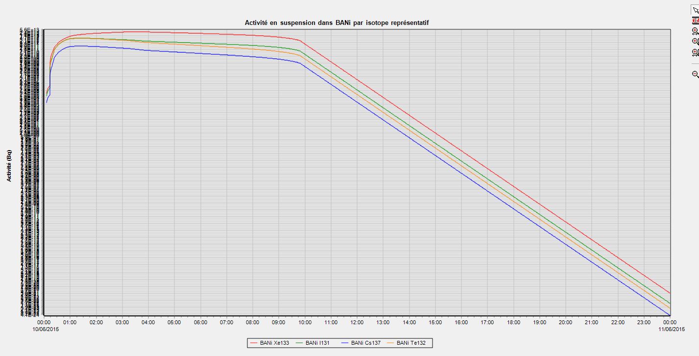

Dear support,
I am trying to fix the maximal number of ticks of the y axis for the attached plot for instance.
Is there some simple approach I could use here to control the number of ticks?
thanks in advance for the feedback.
number of ticks or tick frequency
- Capture.JPG (170 KiB) Viewed 16117 times
thanks,
Nabil Ghodbane (PhD. Habil)

Re: number of ticks or tick frequency
the issue I have here is that I would need to figure out some algorithm to compute the increment value.
Is there some other solution I could use here instead?
thanks
thanks
hI?
many thanks for the prompt reply. Indeed I am not using custom labels. Could it be simply that in my case, since I am using log scale, the algorithm which computes the "optimal spacing " between two consecutive labels is not working.
thanks
thanks
I might have replied too quickly here... What I understand from your email is the following
I need to compute:
1- the size in pixels for the Chart:
2- the number of items for the left axis
3- get the size in pixels of one of the items of the left axis,
I believe one could simply use:
TAxisItem(Chart1.LeftAxis.Items.First).Format.Height; or ???
4- compute the total size of all these items
5- if this size exceeds the size computed at step 1, then remove items from the left axis (or remove their label)
6- iterate until the computed size is smaller than the chart size
does this sound feasible with the 2013 release ?
And my second question: at which "event" do you advise me to implement this algorithm if you think it could work.
thanks
I need to compute:
thanks
I was thinking on clearing all the labels and adding those you want calculating how many can fit given the chart height and the labels height.
Your approach is also valid. I would use OnGetAxisLabel event to hide those you don't want, setting an empty LabelText string in that event.
Take a look at the examples at "All features\Welcome !\Axes\Labels\Custom Labels" and at "All features\Welcome !\Chart styles\Financial\Candle (OHLC)\Axis Labels no Weekends" to see simple examples of how to use Custom Labels and OnGetAxisLabel event respectively.
These examples are in the New Features Demo shipped with the binary installation.
This takes the first axis item. If it exists I don't see any problem with using it.cssesuc wrote: 3- get the size in pixels of one of the items of the left axis,
The idea was a bit different.cssesuc wrote:4- compute the total size of all these items
