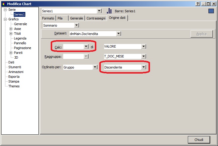

I have a problem with TeeChart PRO 2015.15.150420 and Delphi XE7.
When I connect a series to a data source, settings are not saved properly (both run-time and design-time).
For example, the "Calc" property is cleared and "Order" property is changed.
See before.jpg and after.jpg.
How can I solve this problem?

Post by Daniele Buttarelli » Wed Jul 15, 2015 6:36 am
This occurs with the Italian language.

Hello Daniele,
http://bugs.teechart.net/show_bug.cgi?id=1256
Feel free to add your mail to the CC list in the ticket to be automatically notified when it will be updated.
