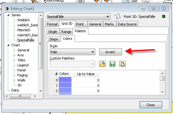

Hey, I found in the EDIT CHART Window an INVERT BUtton!!! I think I can use this for inverting the Rainbow and then it is defined as user pallete. right?

walter0316 wrote:Hey, I found in the EDIT CHART Window an INVERT BUtton!!! I think I can use this for inverting the Rainbow and then it is defined as user pallete. right?
Where did you found that exactly?

Post by walter0316 » Thu Jul 30, 2015 8:22 am
You can find the INVERT BUtton on the
Edit Chart by clicking on the chart and then select the Series and then see my attached Screenshoot.
You just have to select Rainbow and then click on INVERT button.

walter0316 wrote: Edit Chart by clicking on the chart and then select the Series and then see my attached Screenshoot.
Excellent! Chart editor is so extensive... :wink:
