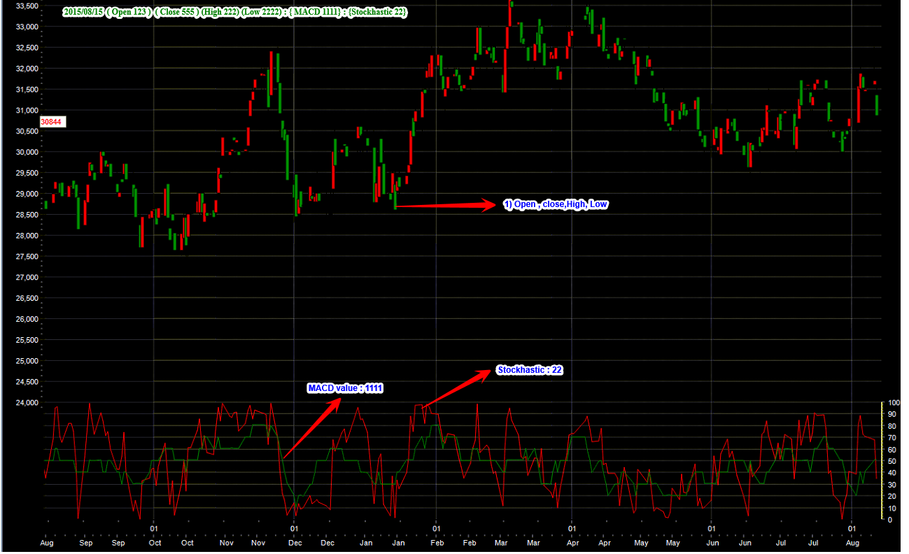

I am at a point were I am stuck and a bit confused with getting the correct x and y values for a specific point on the chart for functions or chart.
In the following example I have a bar chart with a stockhastic and macd function, I am trying to display all the current values at once on a label on the form, but with no luck do I get the correct values at once.
I have included a screen shot with my idea I am trying to accomplish.
Thank you for the support.

I have created a sample application to try and explain what I am trying to accomplish. I am trying to display all the values of the functions and candlestick if I move my mouse over any area of the chart. At this stage the value only diplay if the mouse points to a specific function.

Hi Gucci,
What you request is very similar to the interpolation example (All features\Welcome!\Chart Styles\Standard\Line (Strip)\Interpolating Line series) in the new features demo, available at TeeChart's program group, which I also implemented here. I also attach your project with the modifications applying the interpolating demo.
