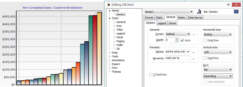

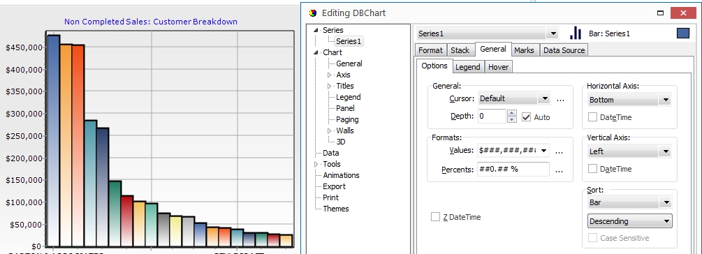

Here is what I'd like to be able to do - these 2 images:
Programatically be able to set what appears to be Series1.General.Options.Sort to "Bar Ascending" or to "Bar Descending".
How do I do that?

Try with this:
  Series1.YValues.Order:=loDescending; //or loAscending
  Series1.CheckOrder;
