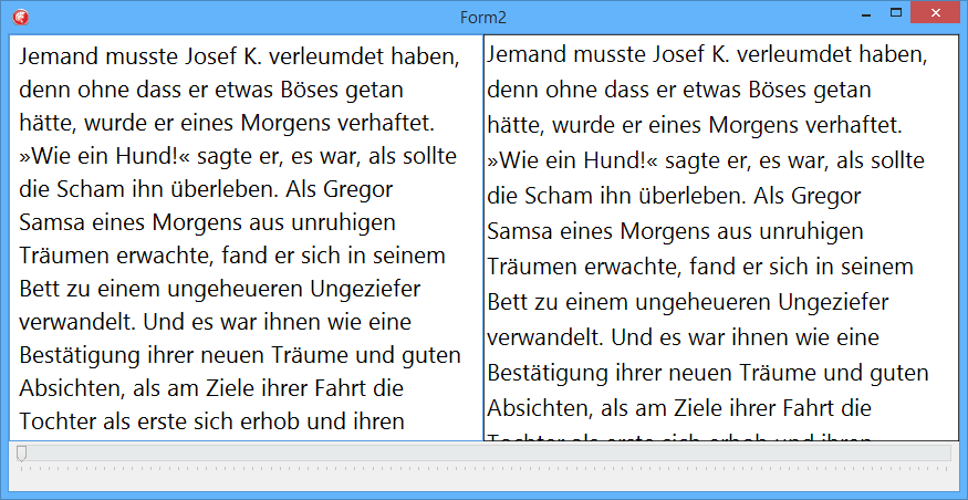

Please have a look at the following image:
On the left you see a normal TMemo straight from the VCL.
On the right, we have a TeeChart with a TRectangleTool on it. By themselves, they both look fine.
However, I am puzzled about the different line height of the TRectangleTool. There is more space between the lines. Is there a way to adjust the "line spacing"? I have found no way.
Many thanks in advance.

This is because TeeChart uses GDIPlus by default since a few releases ago and different techniques are used to calculate the TextHeight.
Adding this to your test project gives a more similar result at both sides:
type
  TCanvasAccess=class(TTeeCanvas3D);
  Chart.Canvas:=TTeeCanvas3D.Create;
  TCanvasAccess(Chart.Canvas).FontQuality:=fqClearType;

Yes, they're almost identical now. Thank you.
It still has a pretty different ... padding compared to a TMemo but I think I can sort that out. Thanks again.
