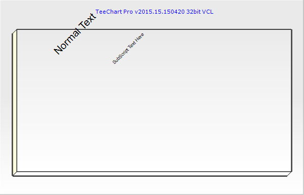

Could it be my version? I just tried a plot Title in HTML and that does not work also (double clicked a plot -> Titles -> Options -> Format HTML) :(
Posts: 9562
Re: Question about RotateLabel
Post by Yeray » Thu Oct 15, 2015 7:59 am
I've just checked it works in v2015.15 for me here:
The position of the Subscript text isn't correct with oblique angles, but the text and the font size look correct.
Note I've added this to output the build version string on the chart title:

... does not work for me :( What could be the issue?

Post by Yeray » Fri Oct 16, 2015 3:33 pm
Looking again at your screenshot I've seen what is making the difference here: RotateLabel method doesn't support HTML5 tags in GDI Canvas.
http://bugs.teechart.net/show_bug.cgi?id=1343
In the meanwhile you can use GDIPlus instead of GDI.
