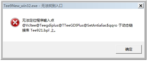

When running New features Demo, the error as follows raises. How to solve the problem? Thanks.
Demo does not work
Demo does not work
- Err.jpg (38.74 KiB) Viewed 9825 times

Could you please add some extra information?
- What OS are you running? Is it 32 or 64 bits?
- Have you installed TeeChart Pro v2015.15 or v2015.16? Did you install it with high privileges?

Delphi 7 and XE 7 have been installed.
OS is 32 bits.
TeeChart pro with source 2015.16 has been installed. but no demo and raise errors as follows:

TeeChart Installation
VERSION: 2015
Installing...
Delphi v7 Enterprise OK. Time: 26s
Win32 v21 Architect (Delphi XE7 and C++Builder XE7 Update 1) (C++)
Tee921
Cannot recompile Delphi package: Tee921.dpk
Embarcadero Delphi for Win32 compiler version 28.0
Copyright (c) 1983,2014 Embarcadero Technologies, Inc.
VCLTee.TeeConst.pas(599) Error: E2066 Missing operator or semicolon
VCLTee.TeeConst.pas(599) Error: E2052 Unterminated string
VCLTee.TeeConst.pas(1001) Error: E2052 Unterminated string
VCLTee.TeeConst.pas(599) Fatal: E2280 Unterminated conditional directive
EXCEPTION:
Compilation aborted.

Re: Demo does not work
When installed TeeChart 2015.15 or 16 in 32 bits, the Demo 32 can not run. The error is "lost rtl210.bpl".
I'd suggest you to install TeeChart with Sources again and make a backup of the "Sources" folder before doing anything else.
Then, you will always be able to take the original version of the files if anyone gets corrupted by any cause.
TeeConst may have been corrupted in your machine at some point between the installation (TeeChartVCLSOURCE-2015.16.150901.exe) and running TeeRecompile. This can happen when a compilation is ended unexpectedly.sripe wrote: Cannot recompile Delphi package: Tee921.dpk
EXCEPTION:
rtl*.bpl is distributed with the IDE, in bin folder of its installation. An error saying it can't be found usually means the PATH in your machine doesn't include a reference to that folder. For XE7 the paths I see in my machine are:sripe wrote:When installed TeeChart 2015.15 or 16 in 32 bits, the Demo 32 can not run. The error is "lost rtl210.bpl".
C:\Program Files (x86)\Embarcadero\Studio\15.0\bin
C:\Users\Public\Documents\Embarcadero\Studio\15.0\Bpl
C:\Program Files (x86)\Embarcadero\Studio\15.0\bin64
C:\Users\Public\Documents\Embarcadero\Studio\15.0\Bpl\Win64
