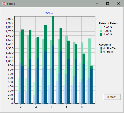

And I got the following result (which is what I want):
But this does not work in the current version I am using--it only shows one legend symbol (the blue ones). (And, as you might expet, the BPAccumChartBeforeDrawSeries event is never called).

I was using v. 15 and have changed to v. 16 and get the same results you do from the demo
But in a previous version of TChart, I got the two different symbols under "Rates of Return" in my first image. How can I get the second column of symbols?

The attached demo can create the following image in 2013.09.131119:
FYI--this is what I need (it would be nice to have less margin between the two legends).

From v2014.10 to v2015.15 the ExtraLegend wasn't shown (id=755).
Regarding the symbols you are manually drawing, note before v2014.11 the Legend.Symbol.Square property was false by default and we moved it to true from that version. This makes your symbols to be squared and the width is incorrect for your purpose.
Add these lines to your TForm1.Create to fix that:
  Chart1.Legend.Symbol.Squared:=false;
  FExtraLegend.Legend.Symbol.Squared:=false;
