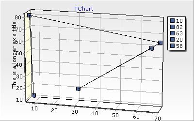

In the version 2015.16.150901 the gap between the left axis title and the axis labels is insufficient if the chart is in 3D mode and Chart.Orthogonal is FALSE (see attached screenshot).
The longer the title text is the more the text moves to the right and overlaps with the axis labels.

hansw wrote:Should I file a bug report? The bug may be related to the fix for the bug 1173
http://bugs.teechart.net/show_bug.cgi?id=1173.
Looking a the code on #1173 it doesn't look the same problem to the one you are reporting. Note #1173 is closed as fixed and the code snippets in it don't reproduce the problem described with the latest version, v2015.16.
I've seen the issue seems to appear after implementing the fix for #742, so I've created a new ticket describing the new issue:
http://bugs.teechart.net/show_bug.cgi?id=1385
