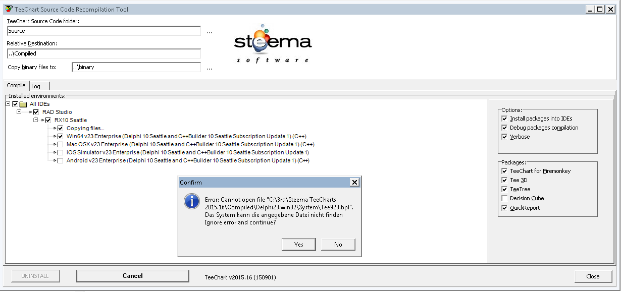

I just setup up a fresh Windows 7 64bit machine with a RAD Studio Seattle 10.1 clean install.
The TeeChartVCLSOURCE-2015.16.exe setup finished without errors, so I went on and ran TeeRecompile to install the TeeChart components into the IDE. TeeRecompile identified the Seattle installation and offered me various targets. I selected only two of them (Win32 v23 and Win64 v23), and TeeCompile presented this error message:
"Error: Cannot open file "c:\3rd\Steeam Teecharts 2015.16\Compiled\Delphi23.win32\System\Tee923.bpl. System cannot find the file specified. Ignore error and continue?"
Can you point me in the right direction?
Kind regards,
Guido Niewerth

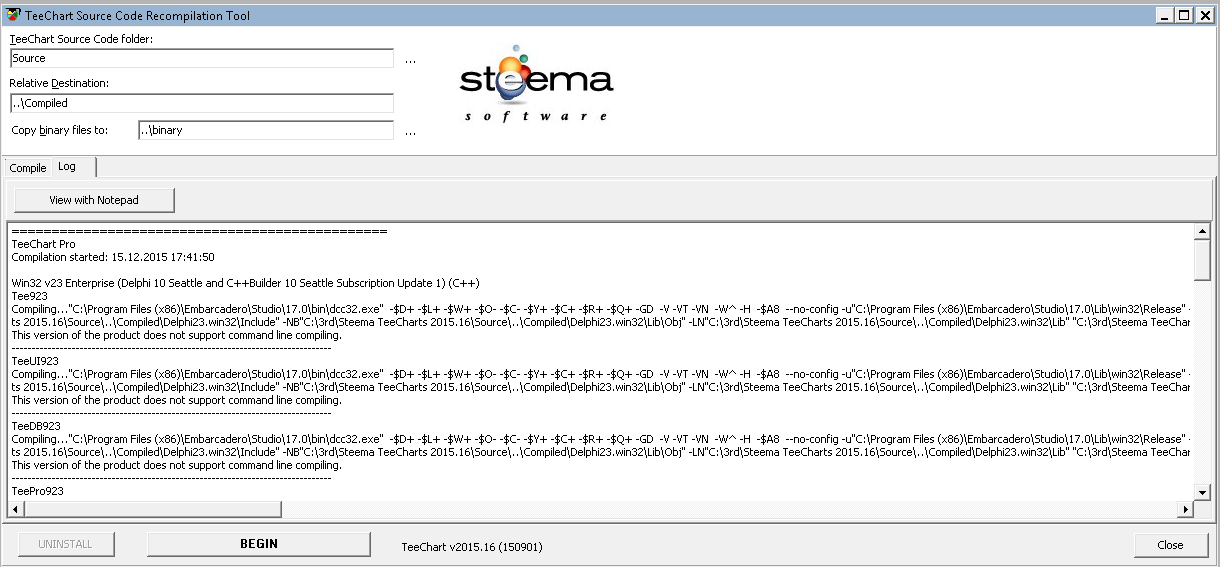

As it turns out it´s RAD Studio Seattle causing the problem. I am using the trial version which prohibts the use of the dcc32 command line compiler.
Invoking the dcc32 compiler yields the error messages shown in the log window.
Re: RAD Studio Seattle 10.1: Cannot install 2015.16
Post by Yeray » Wed Dec 16, 2015 2:04 pm
I was going to ask you what exact version of the IDE were you using.
I'm glad to hear you found the answer yourself.
Note the TeeChart source code license allows you to download the binary version also. Since it comes with the packages already compiled, you shouldn't find this problem with it.
