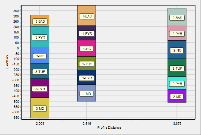

I am currently using stacked bar charts to represent lithology down a well. I formerly used the mbSelfStack mode, but this does not allow positioning of the bar chart on the horizontal axis, so now I am using the mbStacked mode. The data source is a memory table, IntervalQuery, which records the Strata Top, Strata Bottom, Rock Type Code and Color of each lithology down the well. I step through IntervalQuery and assign each layer to a new series, as shown in the code below.
However, when I call Chart.RefreshData, I get n x n layers overlying each other (where n is the number of layers). How do I control RefreshData so only one chart layer is drawn for each record of IntervalQuery? I have attached a diagram showing how a nine-layer well (one layer missing) should look (achieved using mbSelfStack) and how it looks using mbStacked.
Thanks in advance
Errol

How the lithology appears using mbStacked
How the lithology should look

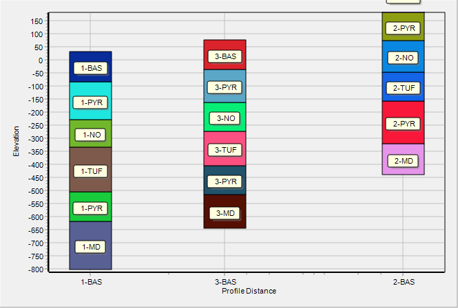

Thank you Yeray for your suggestions. Using MinXValue worked a treat, as you can see in the attached image. However, I have a few small problems that I am still having problems with.
Problem 1. Numeric labels on the x-axis
I am using the following code snippet, but this does not put labels on the axis (although does write the correct title)
      DataSource := IntervalQuery;  // after parent chart

Problem 2. Auto-Scale on the y-Axis
When I plot data against elevation, it does not auto-scale from the highest well elevation to the deepest well elevation, but starts at the highest base of the first bar segment from the top. The code uses YPosition, set to the elevation of each well, and an override version of PointOrigin
function PointOrigin(ValueIndex: Integer; SumAll: Boolean): Double; override;
function TUnitBarSeries.PointOrigin(ValueIndex: Integer;
  Result := inherited PointOrigin(ValueIndex, SumAll);
  if not SumAll then
    Result := Result + YPosition;
Can you suggest a fix to this problem?
Problem 3 Titles for each bar
I would like to write the well name above each well, or perhaps above the top axis or below the bottom axis. D oyou have any ideas on how to do this?
Thanks and regards

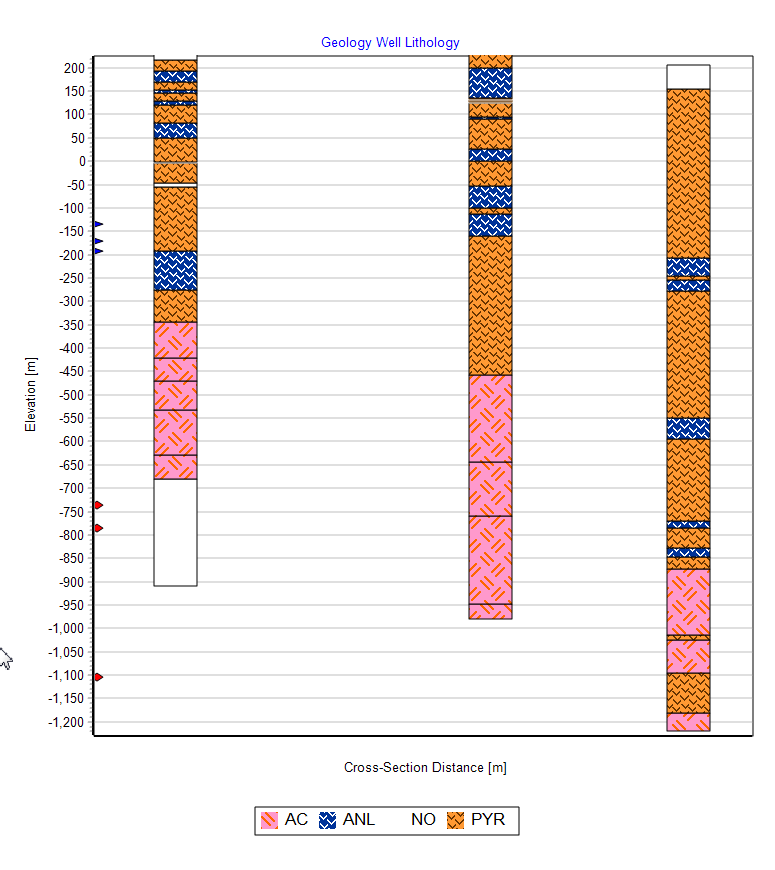

Here is some test code to illustrate the problems I am experiencing. This is written using a memory table (kbmmemtable) as I have problems using TTable. This shows that the horizontal axis labels are the first mark for each chart, not numerical values of ProfileDistance. Also the automatic scale on the vertical axis always starts at the second stratum with the highest elevation.
I look forward to your suggestions.

Posts: 9562
Re: Stacked bar chart problems
Post by Yeray » Fri Feb 19, 2016 9:00 am
Hello Errol,
Errol wrote:Here is some test code to illustrate the problems I am experiencing. This is written using a memory table (kbmmemtable) as I have problems using TTable.
Thanks. I don't have kbmmemtable but I can switch that for a TTable and it works without problems for me here. This is what I get:
Errol wrote: This shows that the horizontal axis labels are the first mark for each chart, not numerical values of ProfileDistance.
Adding this I think makes it to behave as you wish:
DBChart1.Axes.Bottom.LabelStyle:=talPointValue;
Errol wrote: Also the automatic scale on the vertical axis always starts at the second stratum with the highest elevation.
You could override the MaxYValue function also to get it right:
function TMyBarSeries.MaxYValue:Double;
Begin
  result:=YPosition;

Thank you for the MaxYValue suggestion to correct the autoscale. However, for the labels on the x-axis, I prefer a normal axis label format (e.g. every 200 from say 1800 to 4000, rather than labelling the position of each bar chart. Is this possible?
I am also having some problems with the annotation tools to write the well name above each bar chart. I was hoping for series-dependent annotation. I seems quite difficult to write using a chart property, especially keeping the labels aligned when zooming or scrolling. Can you point me to code examples that deal with this.
Thanks and regards
Errol

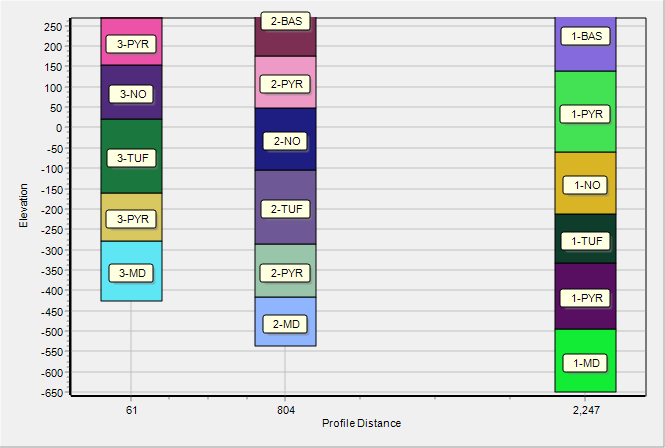

Hello Yeray
Nearly there. I have annotations working but they do not appear until I either mouse over a chart or press Refresh. How do I get these to draw automatically. Also, can I remove the box around the text and just show the name, with no background.
The annotations are also lined up to the left of the bar chart, not the centre. Is there any easy way to automatically centre these?
I have introduced a ToolCount parameter, as I will have other tools on the chart.
Looking forward to your comments
Errol

Posts: 9562
Post by Yeray » Mon Feb 22, 2016 10:21 am
Regarding the bottom axis labels, try changing the bottom axis LabelStyle from talPointValue to talValue. Ie:
  DBChart1.Axes.Bottom.LabelStyle:=talValue;
Regarding the annotations, try forcing a chart repaint at the end of your OnCreate. Ie:
  DBChart1.Draw;
