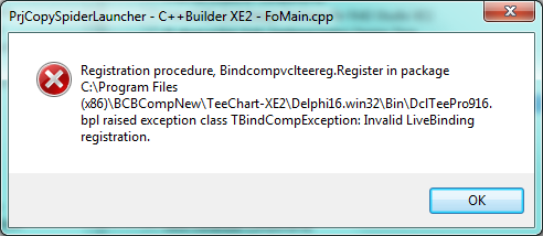

After the installation, when selecting the "TeeChart Pro 2012 VCL Components" in the "Design Packages" list of a test project, I receive the following error message:
Registration procedure, Bindcompvclteereg.Register in package
C:\...\Delphi16.win32\Bin\DclTeePro916.bpl
raised exception class TBindCompException: Invalid LiveBinding registration.

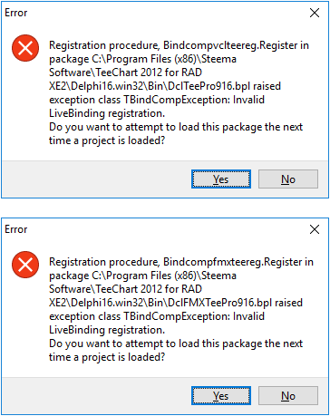

I installed TeeChart Pro v2012.07 and the first time I opened the IDE (always as admin), I got the errors you reported:

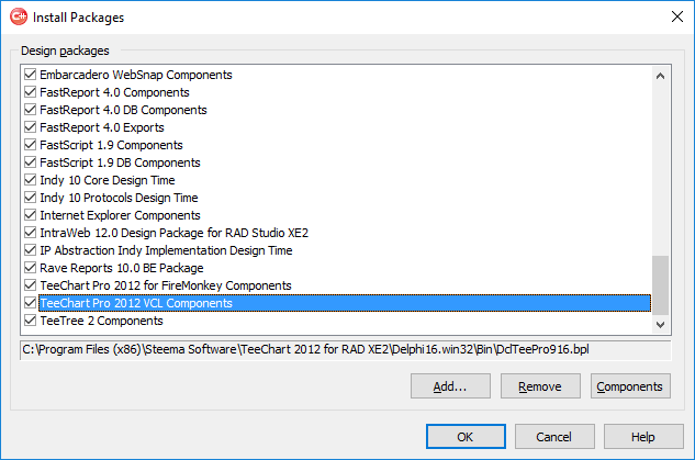

After replying "Yes" to both messages, the IDE loaded. Then I could enable the components without problems on the list of packages:

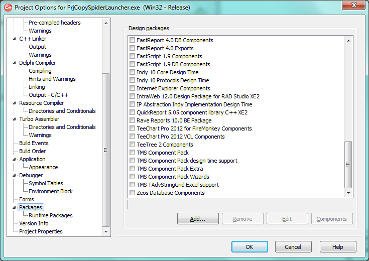

I've uninstalled TeeChart and reinstalled it again. I replied "Yes" as you said. Also, the C++ paths in the "32-bit Windows" platform are OK in my IDE. So, if I create a "VCL Forms Application - C++ Builder", in the Project Options the TeeChart Packages are unchecked:
If I try to select the "TeeChart Pro..." items, I get:
Note that the "TeeTree" package does not rise any exception.
I hope you have some other help about it, because I can't use TeeChart in C++Builder XE2 so far.
Marcelo.
For future reference (Fig. 2).
For future reference (Fig. 1).

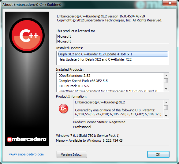

I think it is updated, as you can see in the attached image.
Also, I have TMS Pro, ZeosLib and QuickReport Pro components installed and working fine in the same IDE. Just TeeChart is getting troubled.
On the other hand, you didn't comment that you had the same "LiveBinding registration" error message in your test with XE2, without the same aftermath, but the same error.
What is this error? If there is a error with XE2, maybe there is, or might be, a solution too for XE2. Is that alright?
Any help from now?
Marcelo.
C++Builder XE2 Update 4 Hotfix 1
