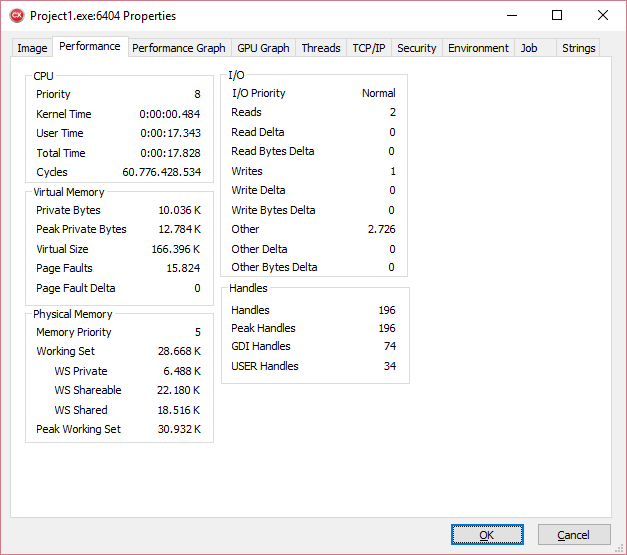

We have been testing with Process Explorer and not even a single byte is lost. Not even adding one thousand nor one hundred thousand points. Task manager may be providing misleading information here. That's Process Explorer output:
Private bytes and working set always have exactly the same initial value when clicking the Clear button.
