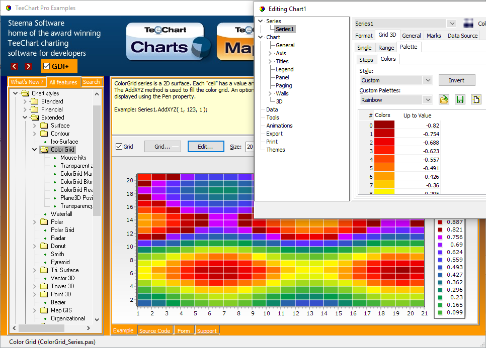

So if I understand correctly, there are a few different ways to set the color in the grid. I say this based on the tchart editor which gives you single, range, and palette. The Range has a "gallery" but when I tried to use that, nothing happened to the colors in the grid. If I went to palette, there were some stock styles which you could use and then adjust the step size. However, if you use a custom palette, the step size does not appear to work. As I played around with the editor and loading a custom palette, I received numerous access violations and often after I would try something, nothing would change after I adjusted anything else. So there seems to be a lot of bugs in this area. That said, I don't really want my users to go through the TChart editor but would prefer to give them controls I've written. So I have the following questions:
1) I'd like to give my users the ability to use different styles when they define a color grid. Can you confirm that the two things I should probably allow them to set are the style and the step size? Which parameters do those correspond to in the Color grid object?
2) I'd also like to allow my users to put in their own color palette, but without having to use the upload feature in the editor. So programmatically, which parameters in the code form the palette where I could set the colors through code?
3) In the custom color palette, I saved one to see how it reads in the colors, and it appears to be the integer version of the HEX color in sequence BGR, not RGB. Why are the colors reversed like that? It is very strange. It took me a long time to figure out that it was using BGR and not RGB.

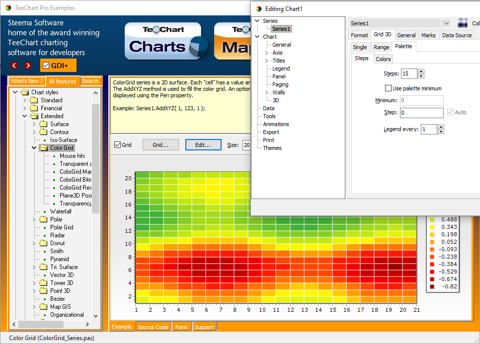

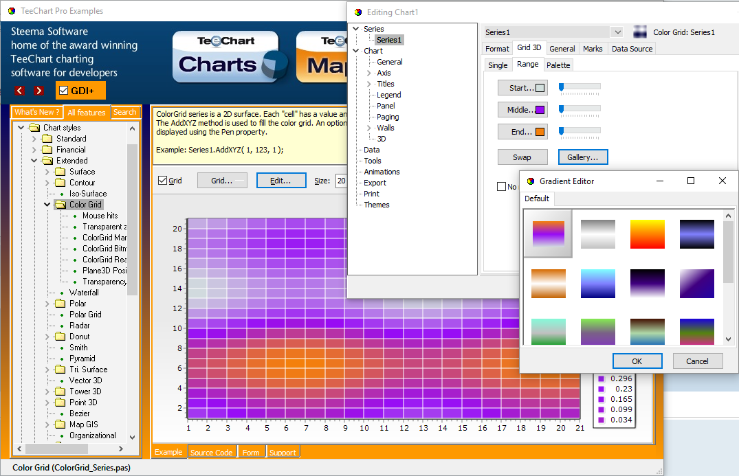

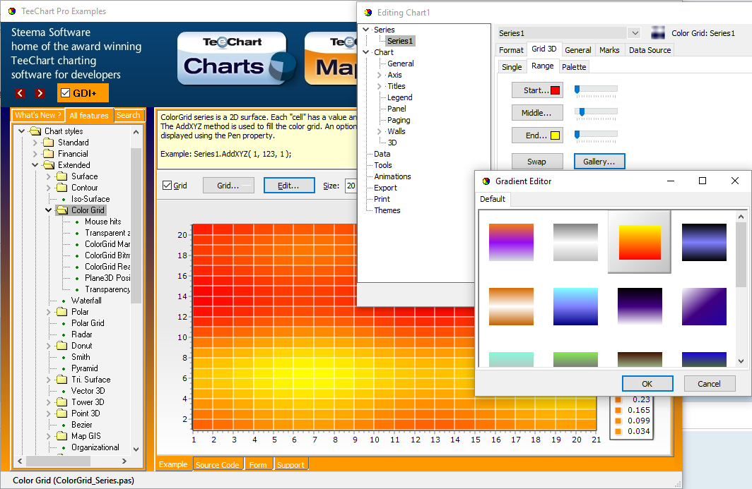

In the ColorGrid example in the Features Demo, if I go to the Range tab, I can change the colors using the gallery. Ie:sde wrote: The Range has a "gallery" but when I tried to use that, nothing happened to the colors in the grid
It seems to work for me. Ie, choosing Rainbow custom palette with the default 32 and 15 steps:sde wrote: However, if you use a custom palette, the step size does not appear to work.
Are you using the latest version available, TeeChart Pro v2015.16?sde wrote: As I played around with the editor and loading a custom palette, I received numerous access violations and often after I would try something, nothing would change after I adjusted anything else. So there seems to be a lot of bugs in this area.

Hmmmm. Yes, I am using the latest v2015.16. And today it is working for me also with no access violations. I must have broken it last week with some combination of clicks which then prevented everything else from working correctly afterwards.
Yes, if you enter less than the number of default steps, it does work fine. But once you go above the number of default steps on any custom style it just repeats the last color. This is in contrast to the built in palettestyles (such as psPale) where if you change the step size, it actually adds and subtracts colors in the palette.

When you modify the PaletteSteps, the CreateDefaultPalette method is called; this method recreates the palette considering the PaletteSteps and the PaletteMin. When using the built in palettes it recreates the whole array of colors and also the array of UpToValues. However, in a custom palette we can't do that because we don't know if there's a relation between the sequence of colors; so we add the colors from the starting the Palette.
Then, if you increment the number of steps in a custom palette one by one, you'll be always adding the first color (ie with the Ranbow palette). However, if you jump from 32 to 40, ie, you'll be re-adding the first 8 colors in a row.

The default palettes are created dynamically only considering the number of steps.sde wrote: Yes, if you enter less than the number of default steps, it does work fine. But once you go above the number of default steps on any custom style it just repeats the last color. This is in contrast to the built in palettestyles (such as psPale) where if you change the step size, it actually adds and subtracts colors in the palette.

So I was able to recreate my access violation situation. So as soon as you adjust the Legend Every value (Series --> Grid 3D --> Palette --> Steps --> Legend Every speed edit) in the TChart Editor, you get an access violation after which nothing else works or you get more access violations. I also received an access violation when I tried to set TColorGrid(Series1).LegendEvery in my code. Can you please see if you can duplicate?

I've been able to reproduce the problem so I've created a ticket on the public tracker:sde wrote:So as soon as you adjust the Legend Every value (Series --> Grid 3D --> Palette --> Steps --> Legend Every speed edit) in the TChart Editor, you get an access violation after which nothing else works or you get more access violations.
http://bugs.teechart.net/show_bug.cgi?id=1506
