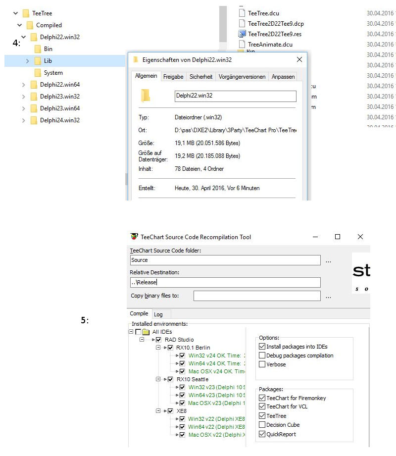

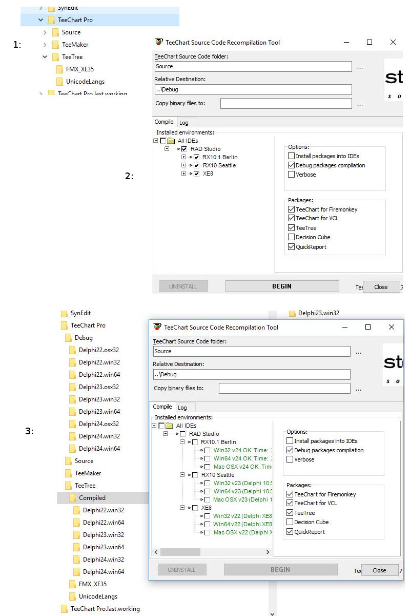

Maybe I was not clear enough, so here is what I do:
1: To start from scratch I deleted all the output directorys (see Explorer tree)
2: First I compile the debug-version (this is necessary because otherwise you end up with TeeTree compiled in debugmode(!)). In Addition to your suggestion I do not install this to the IDE (unchecked that option)
3: I run the compilation and that results in the Explorer-tree shown in the picture. Please not that - while the TChart-Library is compiled to the directory I choose (..\Debug) - the TeeTree - sources are compiled to a hard-coded path called "compiled" (gray mark under the \TeeTree).
4: To clarify that I expanted that directory and made a screenshot of that path (..\TeeTree\Compiled) and its 19.1MB in size)

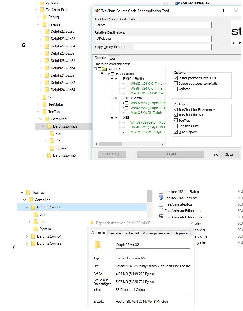

5: Then I change settings to my "..\Release"-path also this time the libraries get installed to the IDE (and debug is checked off)
6: After compilation in the TeeChart Pro directory an additional \Release-path is added BUT if you look at TeeTree below, there is just that harded-coded "Compiled" sub-directory! (This is the reason why you end up with a debug-version installed if you do not compile that version after the debug-version)
7: To be sure I deleted the TeeTree\Compiled sub-order and repeated compilation, then I made the last screenshot. Now the "Compiled" path is back and is 4.95 MB in size.

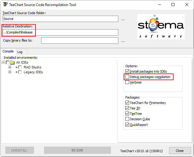

Thanks for the explanation. It clarifies the request so I've added it to the public tracker:
http://bugs.teechart.net/show_bug.cgi?id=1531
In the meanwhile, I guess you could build the "Debug" packages, move the TeeTree packages to an external "Debug" folder and do the same with the "Release" packages.
Of course, moving the packages will give you errors at the IDE startup if you installed the packages to the IDE. But you can manually correct that in the list of packages in the IDE (and also the paths).
