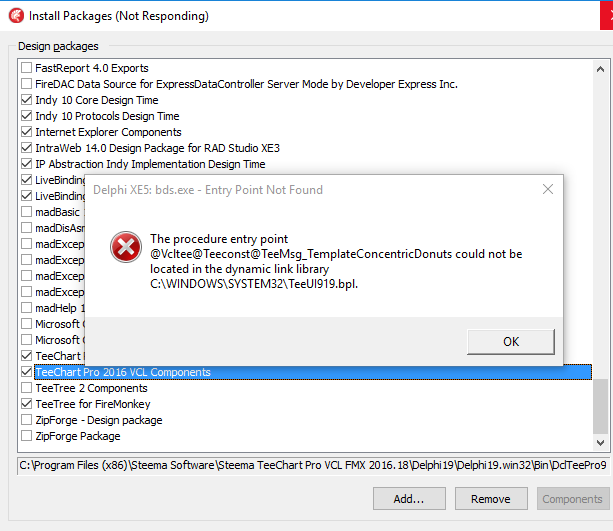

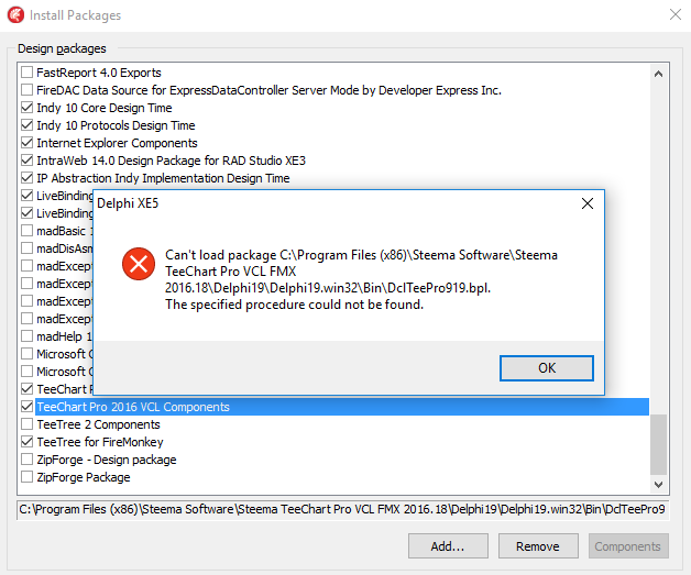

But I still have problems. I tried reinstalling using TeeInstall as you suggest, but there was no change. So I did a full download, again, of the XE5 Teechart Pro install. And in the IDE "Component|Install Packages" I have deselected all third party components. No change. On startup of the IDE I see four error dialogs:
1. The procedure entry point @Vcltee@Teeconst@TeeMsg_TemplateConcentricDonuts could not be located in the dynamic link library C:\WINDOWS\SYSTEM32\TeeUI919.bpl.
2. Can't load package C:\Program Files (x86)\Steema Software\Steema TeeChart Pro VCL FMX 2016.18\Delphi19\Delphi19.win32\Bin\DclTeePro919.bpl.
The specified procedure could not be found.
Do you want to attempt to load this package the next time a project is loaded?
3. The procedure entry point @Vcltee@Teeconst@TeeMsg_TemplateConcentricDonuts could not be located in the dynamic link library C:\WINDOWS\SYSTEM32\TeeLanguage919.bpl.
4. Can't load package C:\Program Files (x86)\Steema Software\Steema TeeChart Pro VCL FMX 2016.18\Delphi19\Delphi19.win32\Bin\DclTree2D19Tee9.bpl.
And if I open Component|Install Packages, and try to select either Teechart Pro 2016 or TeeTree 2, I see similar dialogs (see attached).
