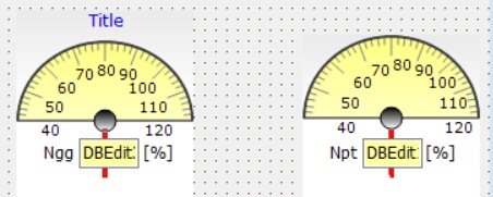

I think I found a strange bug. I am using a TDBchart with a Gauge series. If I make the Title of the chart invisible, the gauge (circular axis) labels shift to the right. I guess this is a bug. I can only workaround by having a small title with only a blank in it.

Hello Wilfried,
I could reproduce the problem so I've added it to the public tracker:
http://bugs.teechart.net/show_bug.cgi?id=1547
