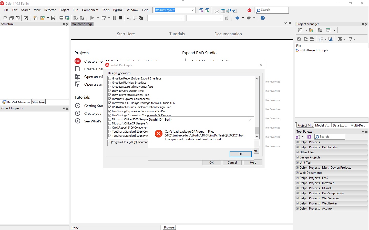

Could you please copy the exact error message here?Carl wrote:It comes up with specified module not found on package install.
Re: QRTeeChart - Missing Datasource. Quick Report 5 and 2016.18
See attached image.
This came up when i followed the instructions. I double checked what i did and could not see where i might have failed.
- Berlin error Quick report Tee Chart.jpg (142.39 KiB) Viewed 80674 times

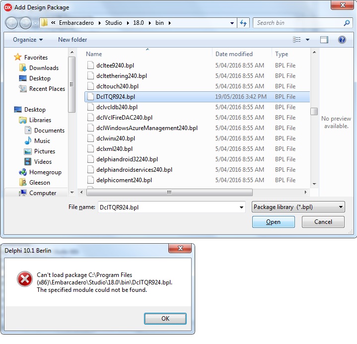

Sorry i uploaded wrong error msg, if you scroll down the image you will the error msg. This was using the package that sandra had a attached.
I checked the modules required within the package and made sure those where available in the Library paths this is 32bit atm. once all is good i will upgrading it to 64bit.
- Berlin error Quick report Tee Chart.jpg (235.45 KiB) Viewed 80652 times

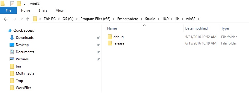

I am still getting the "Specified module not found" msg. I am uninstall teechart and trying again. I do have a question about the paths though as i follow the sheet i see that i need to add it to lib. That is ok however see attached. your documentation may need updating. I even got to the point of adding it in the lib directory plus the 2 sub directories. and still no joy.
- Library Path.jpg (38.97 KiB) Viewed 80622 times
