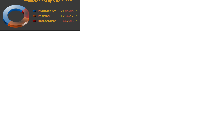

I bought the TeeChart pro version for delphi 7. When I want to animate a pie chart with label and percent values showing each portion are erroneous. The same applies to bar series, however if the sample values show well. See the attachment!
I would also like to know the version I sign says "TRIAL" if I have com meadow (TeeChart Pro v2015.14.150120 trial)?
And every time when modify a chart show error message "property detail not found"
Sin título.png (22.06 KiB) Viewed 8047 times

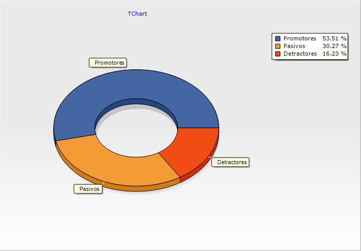

I've tried to reproduce the problem with this code but it seems to give me a correct percentage in the legend:
uses Series, TeeDonut;
  with Chart1.AddSeries(TDonutSeries) as TDonutSeries do
    AddPie(2185.85, 'Promotores');
    AddPie(1236.47, 'Pasivos');
    AddPie(662.83, 'Detractores');
  Chart1.Legend.TextStyle:=ltsRightPercent;
jars wrote:I would also like to know the version I sign says "TRIAL" if I have com meadow (TeeChart Pro v2015.14.150120 trial)?
If you mean in the aboutbox, this is a known issue we corrected in further releases.
