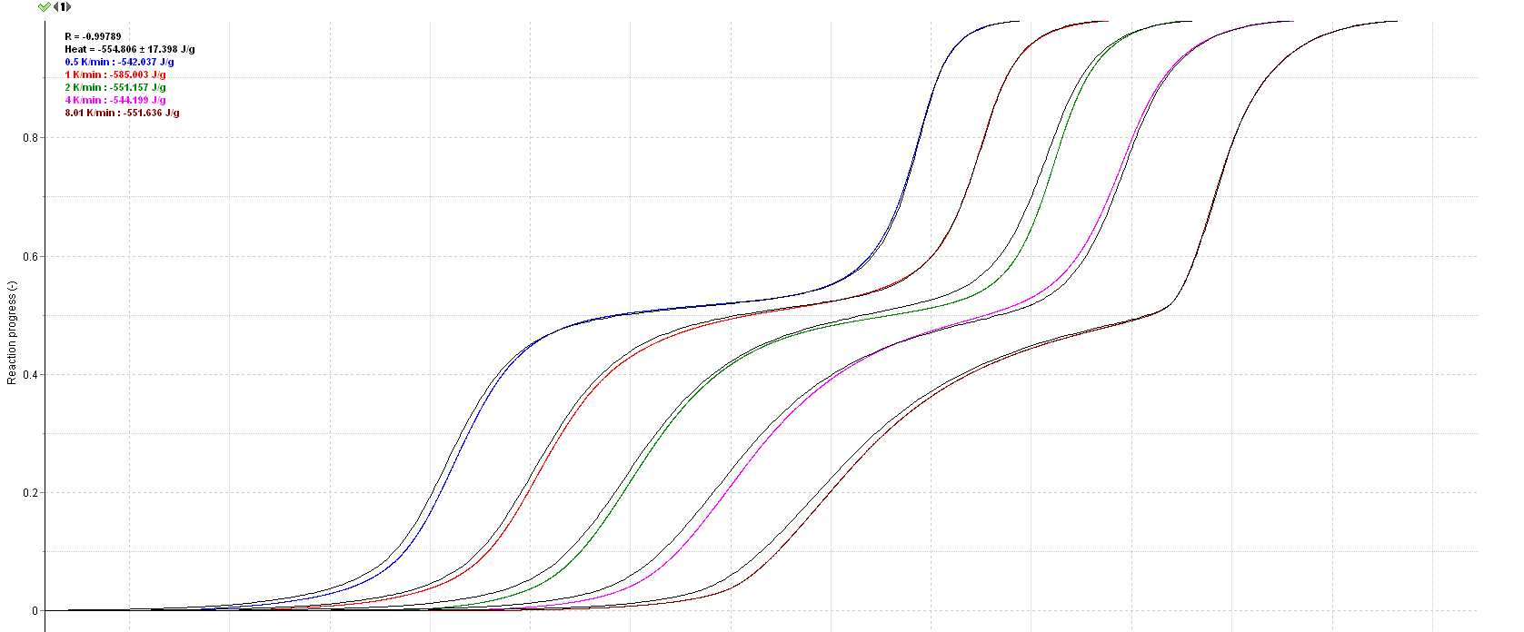

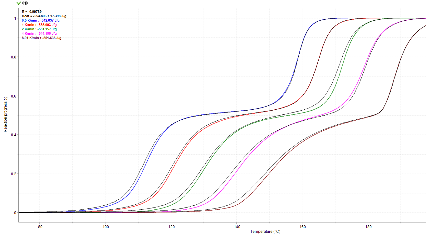

Hello, i have a problem in the new version of teechart 2015 with delphi 10. Comparing to tho old version (delphi xe with teechart 2010 or 2013) then series and axes lines are more bold with the same width = 1 (see attached picture) . How can i have the same look in the new version with a simple change ?
