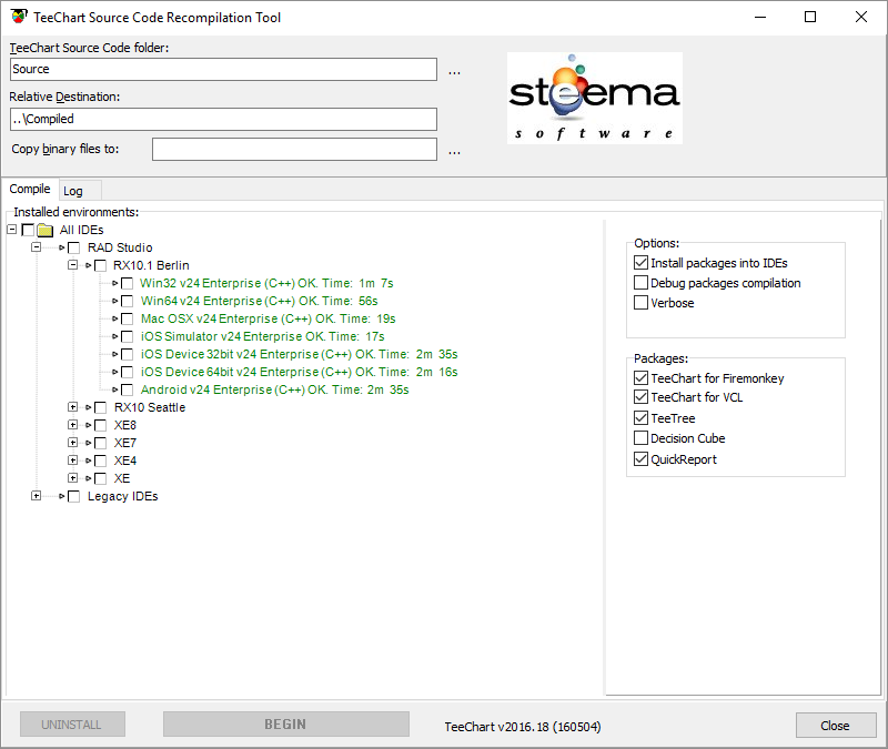

Are you changing the source/destination folders?
This is how it looks for me by default:
If it gives you any compilation error, please open the Log tab to see if there is some extra detail about where does it come from.

Post by Dave C. » Mon Jul 11, 2016 3:20 pm
Yes, those are the folders I have.
