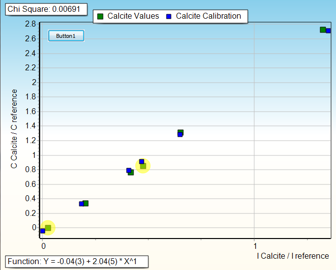

there seems to be a problem with the (X) position of points in the graphics.
Or I am overlooking something. The series values that are plotted are all on the same X value:
The table showing all the same X positions
But in the graphics the points are at different X values:
The graphics showing deviating X positions
To reproduce this please load the chart from the attached tee file.
best regards,
X-Ray

After loading your tee file I see the first 2 series are assigned to the top axis while the third series is assigned to the bottom axis. By default, each axis automatically scales to fit the points in the series assigned to it; but they also add some offset internally to avoid overlapping when possible.
In your case, if you are not going to show the top axis, you can assign all the series to the bottom axis:
  Chart1[0].HorizAxis:=aBottomAxis;
  Chart1[1].HorizAxis:=aBottomAxis;
  Chart1.Axes.Bottom.LabelStyle:=talValue;

Hello Yeray,
Thank you very much for clearing the confusion !
I assigned the other series to the invisible top axis to not show the markers on the bottom axes, but rather the values.
The call:
is of course the right measure to achieve this.
