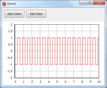

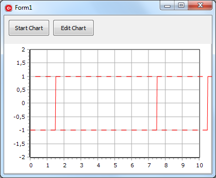

Re: TFastLineSeries AutoRepaint Problems
Hello Sandra,
Thank you for your info.
Setting the chart AntiAlias = false worked for me as a workaround for the FastPen color problem.
I know, setting AutoRepaint = true solves the problem. But AutoRepaint = false reduces the CPU utilization a lot in my application.
There is no significant speed reduction for many seconds. Therefor I would like to use this feature.
For me this seems to be a bug in TeeChart only when painting vertical lines.
This picture shows the error: After chart repaint with mouse unzoom: Is there a chance, that this bug is fixed in the next release?
Hello Sandra,
Thank you for your help. But I only see the clipping bug in your Bugzilla request.
I don't see the bug with the missing vertical lines (see pictures above) with TFastLineSeries properties:
AutoRepaint = false
DrawAllPoints = false
DrawAllPointsStyle = daMinMax
Kind Regards
Edgar
