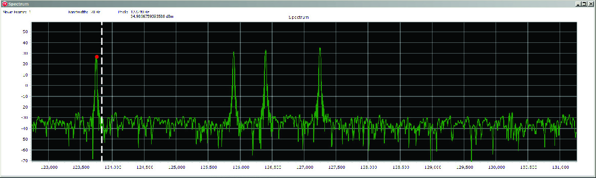

1. I’m looking to put a maker on a Series. A red dot or a dotted white line.
2. I want text as value for the Y side of the chart, is that possible?
I'm using C++Builder Seattle Update 1
- chart2.jpg (168.39 KiB) Viewed 12605 times
- chart.jpg (328.8 KiB) Viewed 12572 times

You can use a TColorLine for this. Ie in Delphi:pcs_user wrote:I’m looking to put a maker on a Series. A red dot or a dotted white line.
with Chart1.Tools.Add(TColorLineTool) as TColorLineTool do
Pen.Color:=clWhite;
Pen.Width:=2;
Pen.Style:=psDash;
Axis:=Chart1.Axes.Bottom;
Value:=123750;
You can change the Labels Style to talValue. In Delphi:pcs_user wrote:I want text as value for the Y side of the chart, is that possible?
Chart1.Axes.Left.LabelStyle:=talValue;

Re: Added a Maker & Text
Yeray,
I’ll try to clear it up for you.
I don’t know how to get the x value of the vertical white dashed line (TColorLineTool).
I know how to drag the vertical white dashed line.
I want the “y” value from Series1 on the chart when I move the vertical white dashed line so I could display it on the chart.

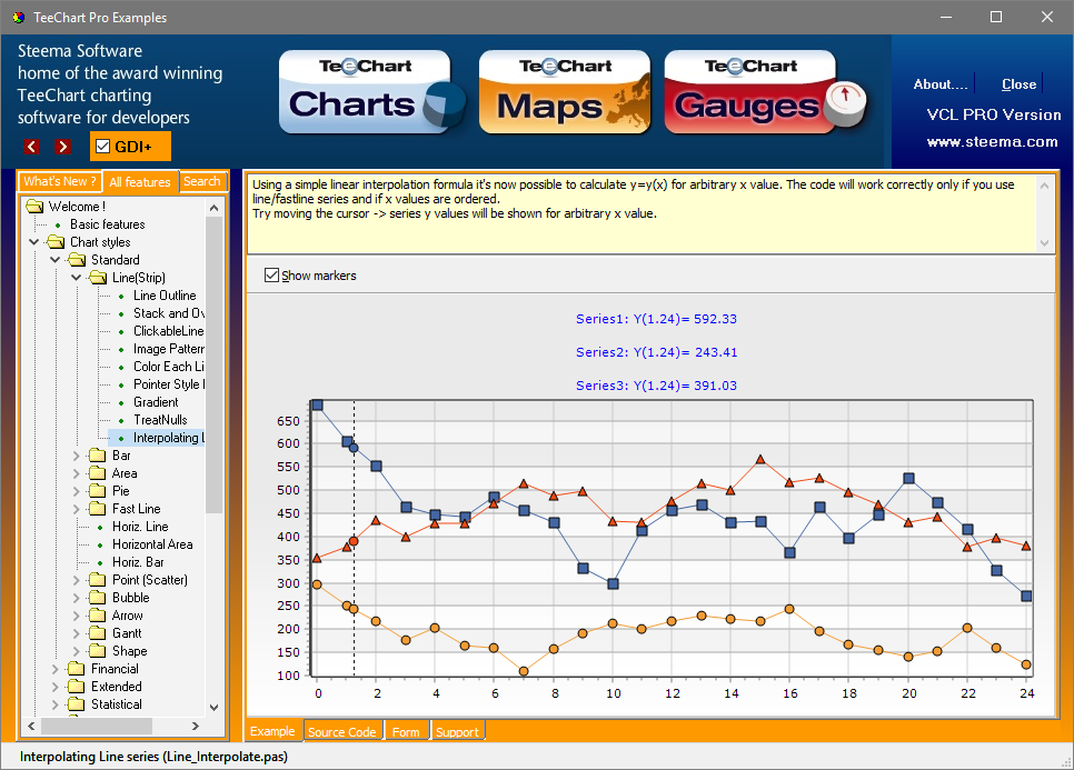

Have you seen the demo at "All features\Welcome !\Chart styles\Standard\Line (Strip)\Interpolating Line series"?
I believe it does pretty much what you are trying to achieve.
The Features Demo is shipped with the binary version.
The binary version is the version without sources, where the packages come precompiled.
This version includes the examples and the documentation. You should find a shortcut to the "New Features Demo" in the TeeChart group in the start menu. Alternatively, you can find the Tee9New*.exe at the "Examples" folder in the TeeChart installation path.
