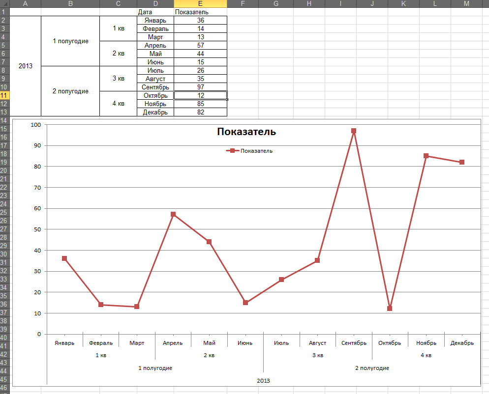

Horizontal axis with multi-level categories (like Excel)
Post by MIKE » Fri Sep 09, 2016 12:45 pm
Is it possible?

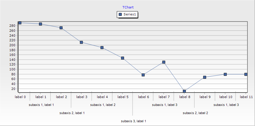

Post by Yeray » Mon Sep 12, 2016 9:05 am
You can use SubAxes as follows:

Note I had to manually draw some of the ticks.

Yeray wrote:Note I had to manually draw some of the ticks.
I've modified the code to draw the ticks to do it a more generic:
