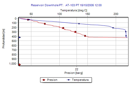

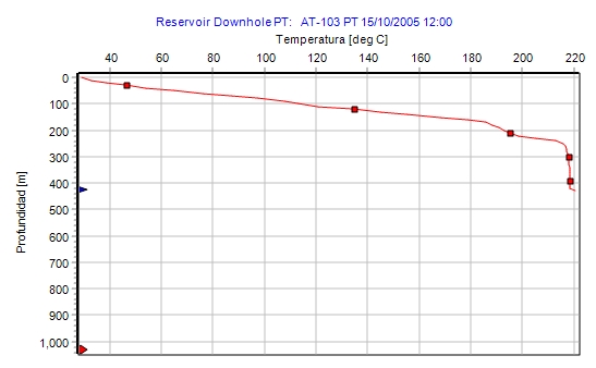

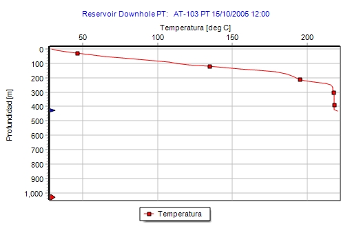

Thanks for your reply. I can assure you that the series has values. I have attached 3 images showing the behaviour of the program before and after installing TeeChart 2015.15 in July 2015, using the same data. As you can see, the legend was displayed with a single series before TeeChart 2015.15, and not displayed after.
Chart with two series before TeeChart 2015.15
Chart with one series before TeeChart 2015.15
Chart with one series after TeeChart 2015.15
I do not understand why this legend error does not occur with a simple example, but it definitely occurs in our program, and the only change to the code has been the installation of TeeChart 2015.15. I notice that TeeChart sets the InternalLegendStyle to lsValues if ActiveSeriesInLegend = 1 (see code below). It appears that this change means that legend placement is different for a single series chart in some cases.

I believe I have worked out why TeeChart is failing to show a legend with a single series. You may remember that some time ago I requested an option to limit the number of points displayed in a series without changing the series. I have attached two images to show a typical series with all points displayed and only five points displayed.
Chart with only five points displayed per series
Because Steema have not yet offered this option, we have developed our own version which involves creating 3 series for each set of data, a Line Series, a Fast Line Series and a Point Series. The Fast Line Series and the Point Series are plotted on the graph but not shown in the legend. The line Series is used only for drawing the legend, and is not plotted on the graph. To achieve this functionality, I detached the Line Series from the data source using the following code.

And I found the legend comes back if I force its LegendStyle to lsSeries:
  Chart1.Legend.LegendStyle:=lsSeries;
