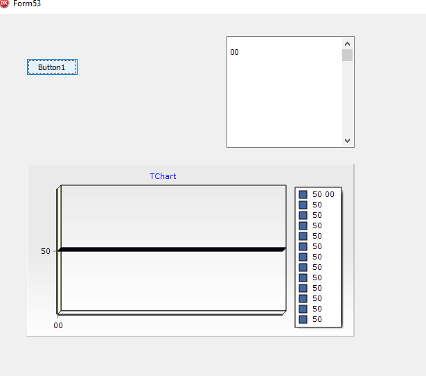

I'm not sure to understand the problem here.
I'm getting the same result in both RAD 10 Seattle and in RAD 10.1 Berlin.
After one click on the button: After 2 clicks on the button:

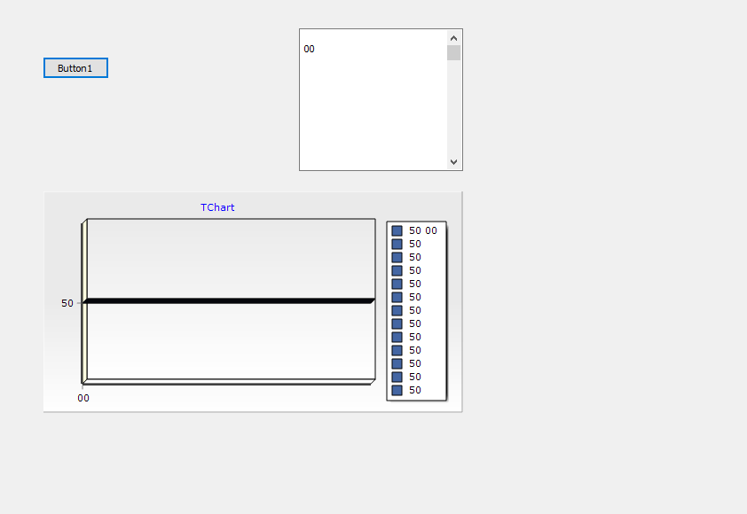

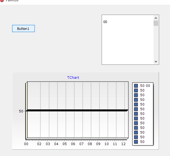

I didnt mean for you to do 2 clicks
(as the data is not cleared between clicks)
i have attached 2 screen shots, after clicking on button1 once
first is when using seattle, second using berlin
with berlin there is no time stamps on the x axis as there is with seattle (same code)
that is the problem
not sure how I could make it more clear
that is the problem
- graph2.png (9.07 KiB) Viewed 25069 times
- graph1.png (10.47 KiB) Viewed 25073 times

Re: problem with x axis time
also just to add, that the behaviour as shown with seattle (i,e the axis labels being drawn) has always been the behaviour with eveyr Delphi version for me (for the data in the memo plotted)
but Berlin and the version of tchart pro I updated to for Berlin,changed that behaviour (as you can see in the screen shot)
