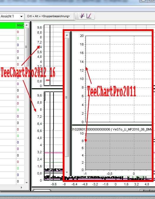

by changing TeechartPro 2011 to TeechartPro2012_2016 my application will have a Problem by scaling the axis. If I have paramized on manual axis mode, scalation from 0 ..10, scale step 0.1 and a small chart size, I see the scalation starts from 0 with the steps of 0.8 . The end value of 10 will be not displayed.
How can I Change this ?
Inside the little graphic file you can see this better !

weidunu wrote:If I have paramized on manual axis mode, scalation from 0 ..10, scale step 0.1 and a small chart size, I see the scalation starts from 0 with the steps of 0.8 .
I understand that's the correct behaviour. setting an Increment of 0.1 means the chart will try to draw labels with that increment when they aren't overlapping. If they are overlapping, TeeChart searches for the minimum increment that will allow drawing the labels without overlapping, from that value you've set. So the size of the axis and the labels font also affect this internal calculation.
If you want to force an increment, being responsible of the label overlapping, you can use custom labels.
weidunu wrote:The end value of 10 will be not displayed.
Have you tried adding some MaximumOffset to the axis?

sorry for writing so late, but I was very bussy. I set the range of an axis with the SetMinMax-function and in the past it works very fine.
The old algorithm was for me better.

Post by Yeray » Mon Dec 19, 2016 9:24 am
Hello Udo,
We'll be pleased to check what changed and if there's anything we can improve if you can arrange a simple example project we can run as-is to reproduce the problem here.
