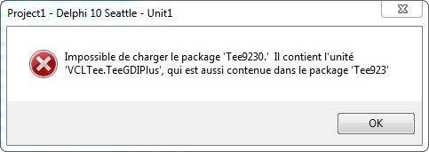

I just Bought TeeChart Pro 2016.19 with source and i need to integrate QRChart in QuickReport 5.06.2.
So i downloaded the latest version of TQRChart : Tee9QR5D23Std in the additional downloads.
When i want to add the package, i have the message : (See attached file : AddPackage.jpg)
I tried to recompile the package but i have an error : "Tee not found".
I have browsed the forum and i saw that several people have the problem.
Do you have a solution please ?
TQRChart & Delphi 10 Seattle Enterprise
- AddPackage.jpg (19.88 KiB) Viewed 8556 times
Re: TQRChart & Delphi 10 Seattle Enterprise
Hello rxseac,
The error message "Cannot load package Tee9XX. It contains unit *, which is also contained in package Tee9XX0" indicates that the TeeChart package that was shipped with the IDE (Tee9XX0) is still trying to be loaded, and this creates a conflict with the version you've just installed. I would like suggest you take a look in that thread to try fix the problem.

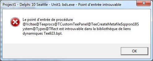

Hi Sandra,
Thanks for your replie.
I have already disabled the FactReport Packages as requested in the thread as you can see below This is the error message displayed when I tried to add your Bpl Any idea ?
Hello rxseac,
I would like suggest you take a look to HowTo setup Paths in the IDE to try fix the problem.
Hoping this helps, otherwise don't hesistate to contact us.
