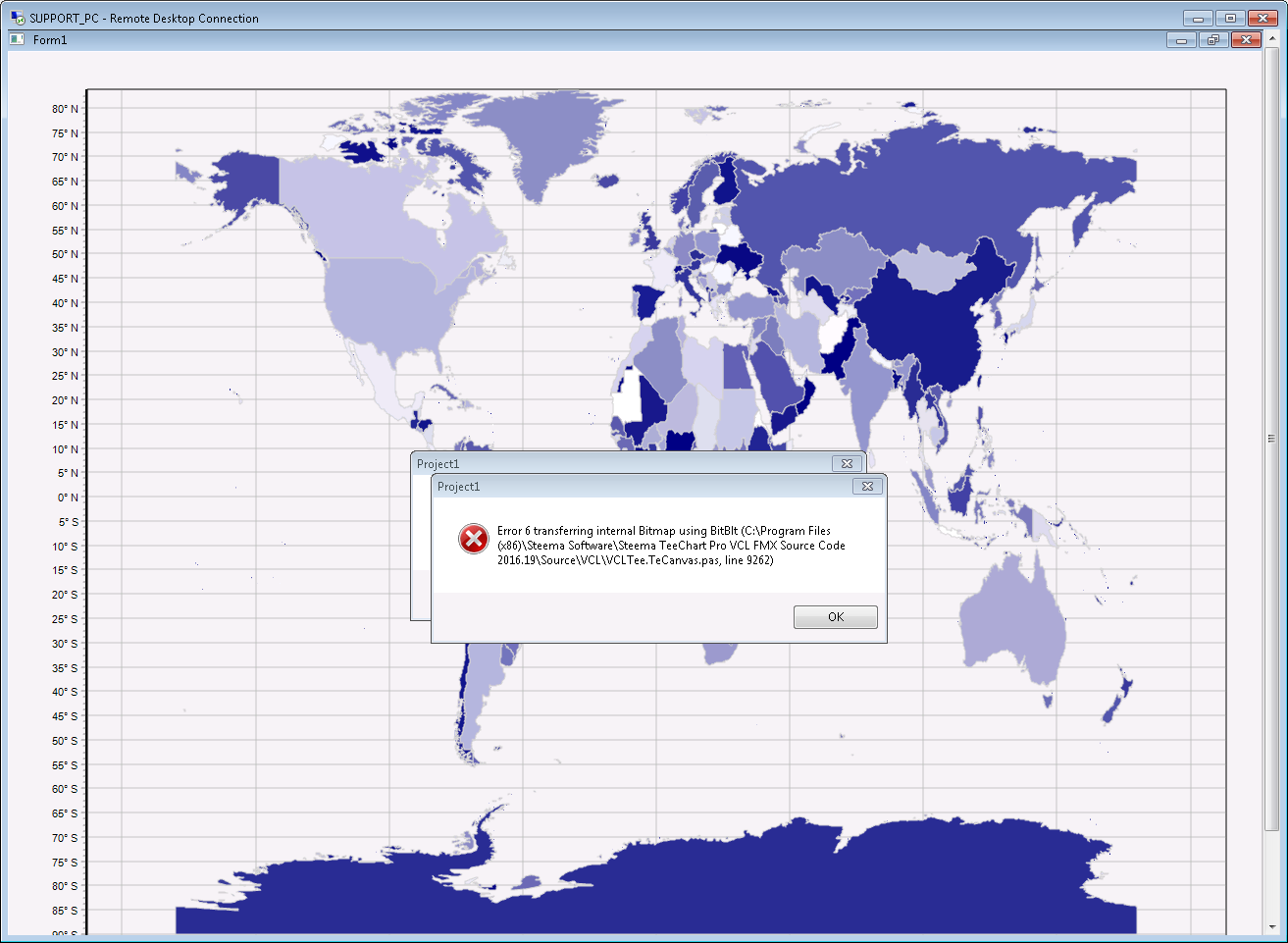

Error 6 from Windows 7 machine.png (133.62 KiB) Viewed 10643 times
I downloaded your attached code, added the Win64 platform, the search path to the source code and an output directory.
I can reproduce the error, but only on Windows 7 machines. It seems to work if I run the same exe on a Windows 10 machine.
Best Regards
Johanna

Hello Johanna,
I reproduced the error now, with a Windows 7 x64 virtual machine.
You don't even need to use remote desktop to reproduce the problem. Just logout through "Switch user" option and login back.
I'm also reproducing the problem without having the window maximized and targeting Win32 platform.
Still investigating...
