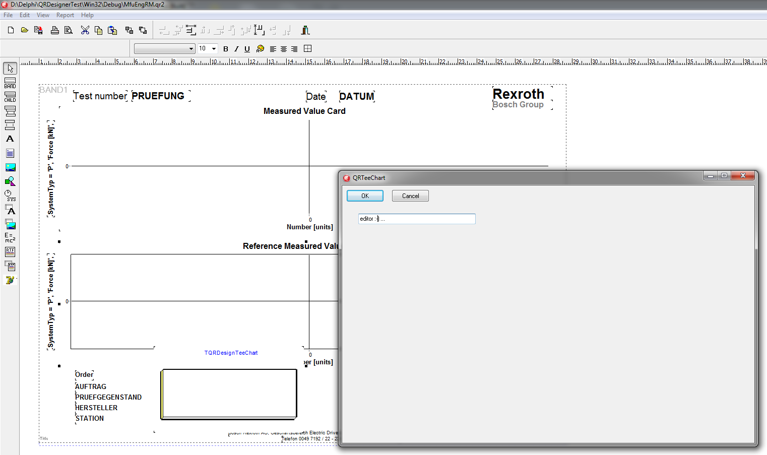

how can I integrate TeeChart Pro into Quick report designer 5.06 for Delphi XE8?
(to create or modify quick report in my application)
I installed TeeChar in Delphi and package for quick report, It works. I can place a chart on form or on a report but only in delphi ide.
Tee chart wasn't integrated in TReportDesignerDialog so I can't work with chart in quick report when application is running...
How to add it to TReportDesignerDialog?

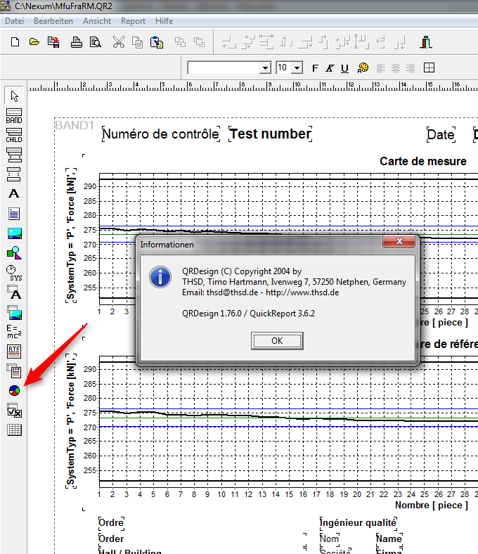

I need it works the same way as in the old version of quick report designer...see attached print screen of an old quick report designer, there is teechart integrated
thanks for help

There is attached unit which should register tqrchart in quick report designer
My application fails in initialization of unit qrd3rdpartycontrol_QRDTeeChar with message runtime error 217 at 004BC068
thanks for help

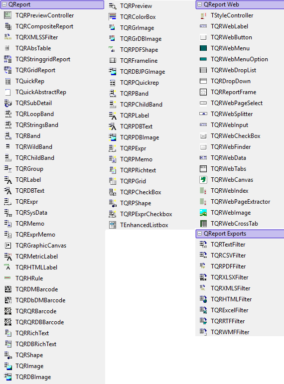

I've tried to use this unit in a Delphi 7 with QuickReport 5 installed, but I can't find any TQRepDesigner in my installation.
This is the palette I see in QuickReport tab:

Here the list of components I get for QuickReport 6 Pro for RAD XE 10.1 Berlin. I can't find any *Designer*:

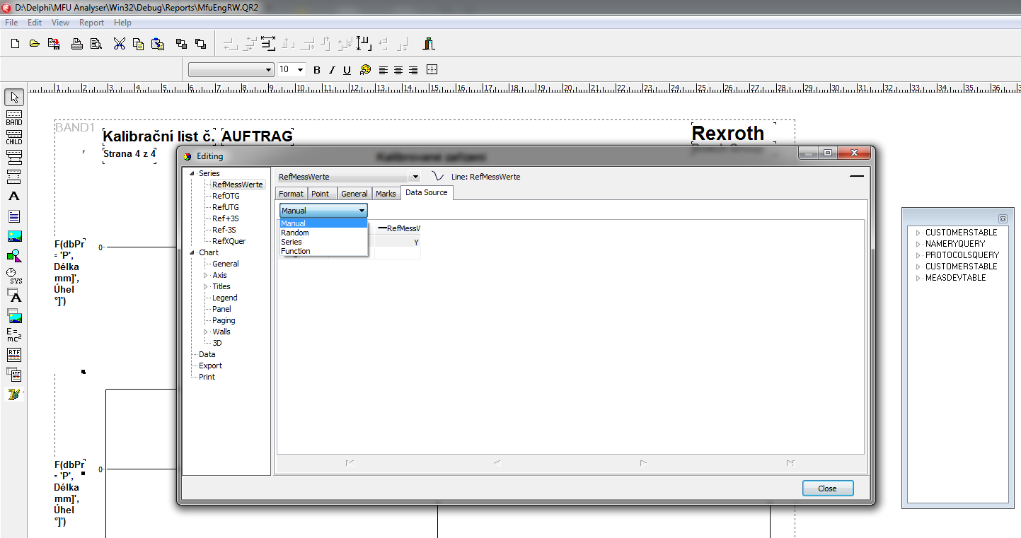

EditChart works fine, but I miss Dataset in series/datasource
How can I add dataset? and how add list of tables...
(in Delphi IDE dataset and tables are available)
