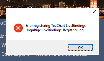

I've disabled Live Bindings in Delphi 10.1.. It did this because of massive performance problems in bigger projects. I did it the following way: Removed / disabled the three Live Bindings packages from embarcadero.
Since it did that TeeChart Pro complains at every start about it: "Error registering TeeChart LiveBindings: Invalid registration". I tried to bypass this with reinstalling the TeeChart components, but i had no success.
Is there anyway to disable / get rid of live bindings in teechart pro, too?
