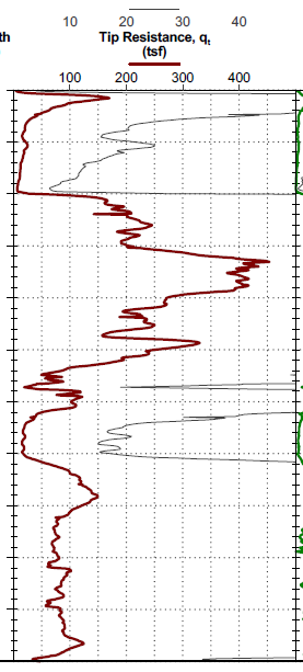

I am investigating the possibility to have dual X scales on a plot (attached is an example), is this something that TChart supports?
Thank you very much for your time

One possibility could be to use both Horizontal axes (Top and Bottom) as in the following example:
procedure TForm1.Chart1GetAxisLabel(Sender: TChartAxis; Series: TChartSeries;
  ValueIndex: Integer; var LabelText: string);
  if Sender = Chart1.Axes.Bottom then
    LabelText:= FormatFloat('#,##0', StrToFloatDef(LabelText, 0) / 10);
  Chart1.View3D:=False;
  Chart1.Legend.Visible:=False;
  Chart1.MarginBottom:=10;
  with Chart1.AddSeries(THorizLineSeries) as THorizLineSeries do
    FillSampleValues;
    HorizAxis:=aBothHorizAxis;
  Chart1.Axes.Bottom.OtherSide:=True;
  Chart1.Axes.Bottom.Grid.Visible:=False;
  Chart1.Axes.Bottom.Ticks.Visible:=False;
  Chart1.Axes.Bottom.MinorTicks.Visible:=False;
Another similar possibility could be to use a SubAxis. Ie:
  if Sender = Chart1.Axes.Top.SubAxes[0] then
    LabelText:= FormatFloat('#,##0.##', StrToFloatDef(LabelText, 0) / 10);
    FillSampleValues;
    HorizAxis:=aTopAxis
  with Chart1.Axes.Top.SubAxes.Add do
    Axis.Visible:=False;
    LabelsFont.Name:=Chart1.Axes.Top.LabelsFont.Name;
