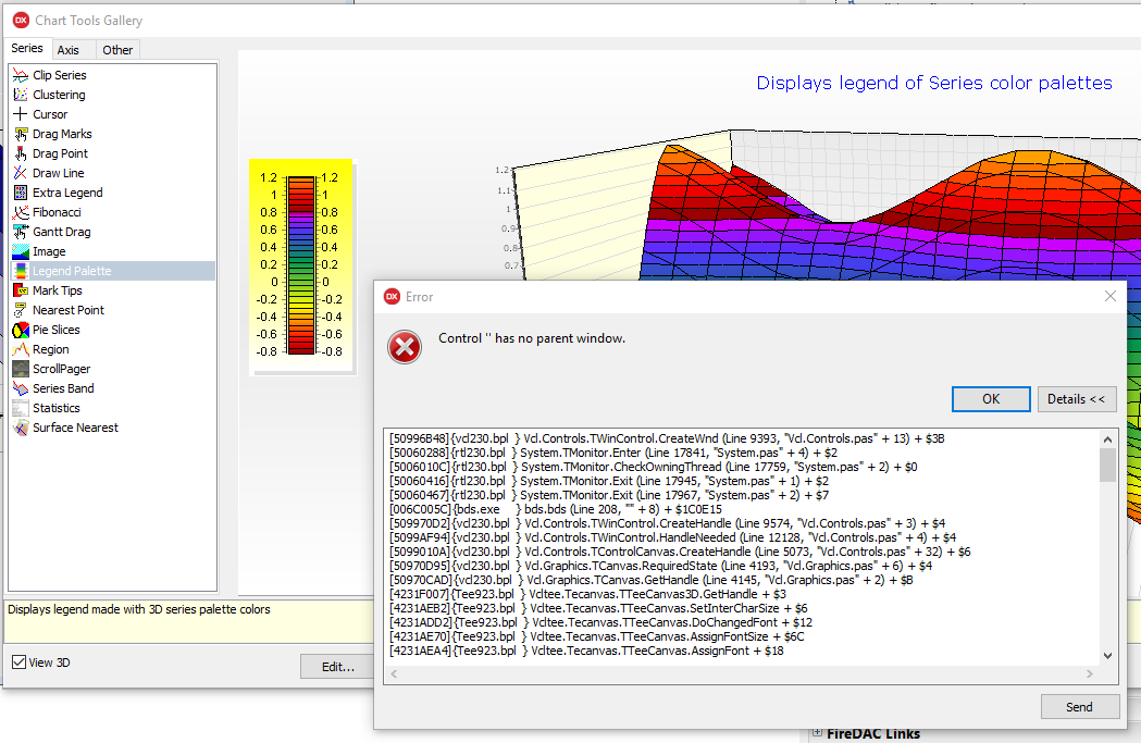

I just upgraded to the latest TeeChart VCL 32 bit version and I am still having issues with the Legend Palette, once this object is added to a chart and the mouse goes inside the chart area I get this error message. Can you please provide some guidelines on how to identify and fix this issue?

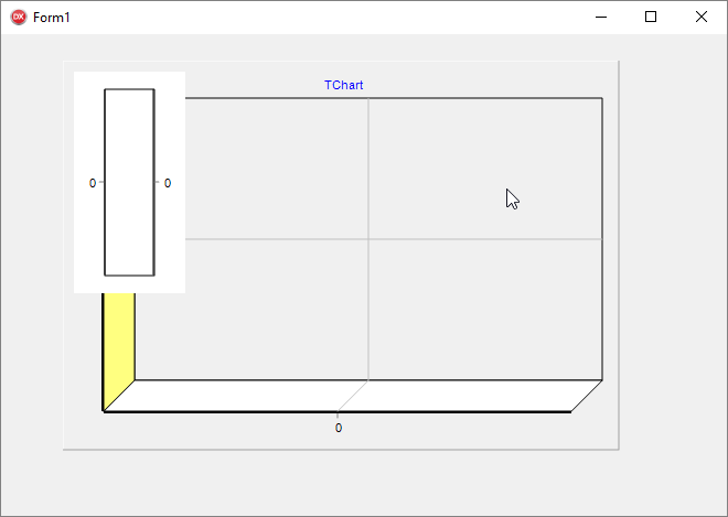

This is what I see with that exe. I can't find how to make it to crash:

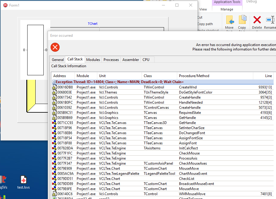

Wow, how can this be possible? When I move the mouse over the chart I get the error (I included a screenshot from EurekaLog running, maybe someone could have some idea?)
Yes, the issue appeared with my Delphi XE7 version but after I upgraded to XE10 with a clean install I thought it would "magically" go away as it was almost obvious that this is an issue with my installation.... If anyone has any idea about this please let me know, I removed the legend palette from my app and wish to include it again.

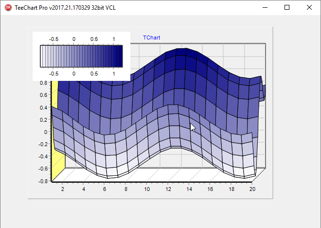

This is how it works for me:

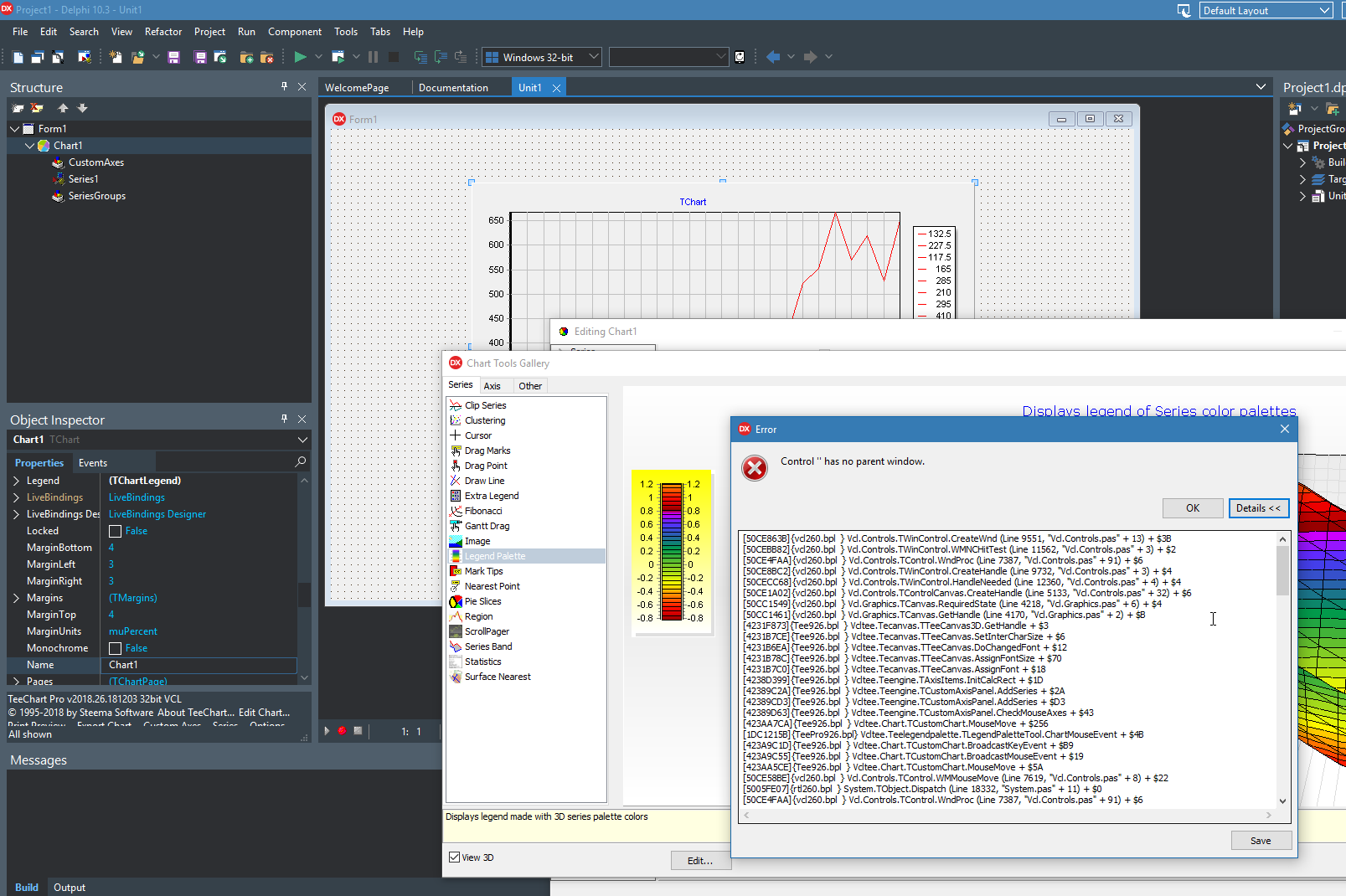

This looks as the continuation to this thread:
viewtopic.php?f=3&t=16547&p=74219#p74219
where we weren't able to reproduce the problem you are reporting.
I've just tried it using RAD 10.2.3 Tokyo + TeeChart v2018.25 without being able to reproduce any problem.
I'll give a try at the new TeeChart v2018.26 both with RAD 10.2.3 Tokyo and RAD 10.3 Rio and let you know.
Re: Still cannot use Legend Palette
Post by Yeray » Mon Dec 10, 2018 8:22 am
Yeray wrote:
Mon Dec 10, 2018 8:04 am
The Legend Palette Tool seems to work without issues using TeeChart Pro v2018.26 in RAD 10.2.3 Tokyo and RAD 10.3 Rio here.
