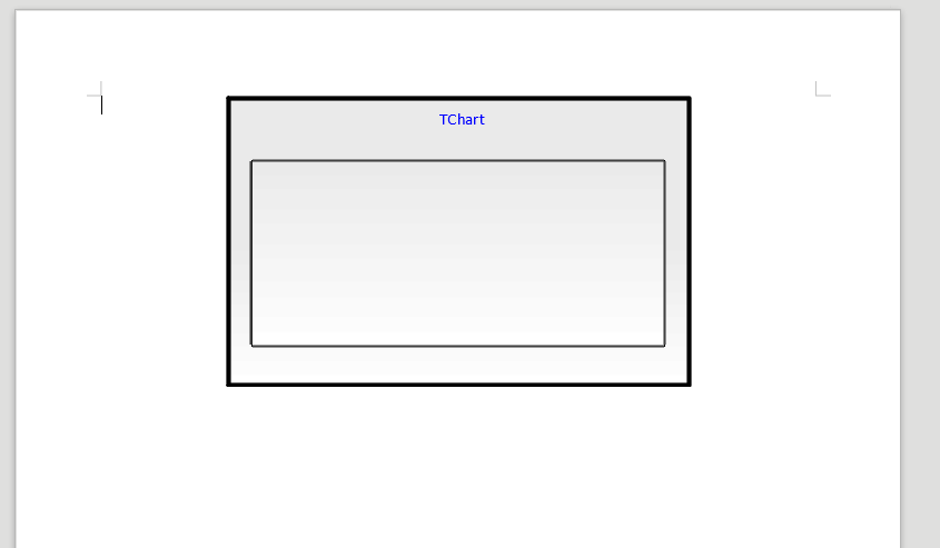

I've just tested it with a new simple example project with just a TChart on a Form and a Button:
  Chart1.View3D:=False;
  Chart1.Border.Visible:=True;
  Chart1.Border.Width:=4;
  Chart1.BevelOuter:=bvNone;
  Chart1.BevelInner:=bvNone;
  Chart1.CopyToClipboardMetafile(True);
After clicking the button, I can paste the chart in a paint and in a Word/Writer document and I see the 4 borders:
I'm using TeeChart v2017.21. What version are you using?

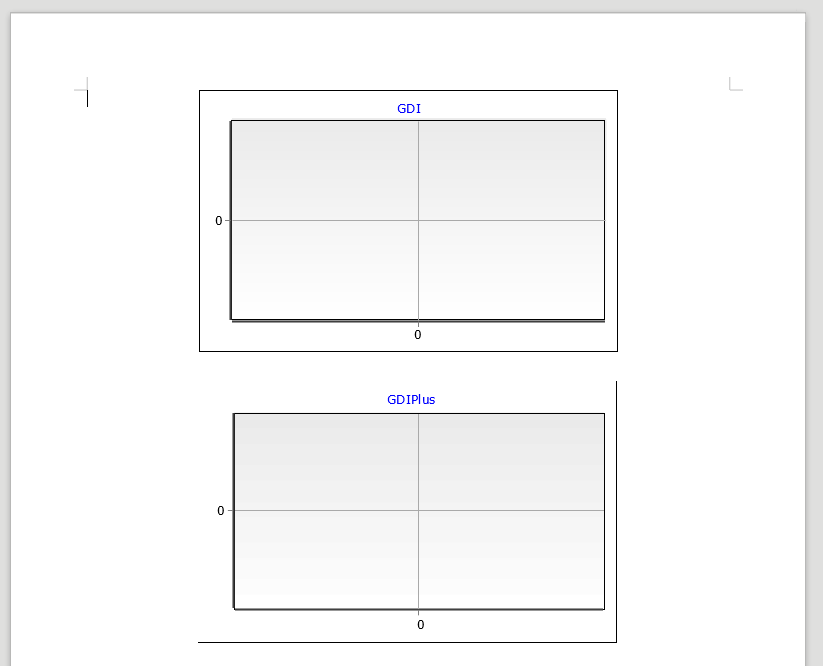

I've checked it with old versions and I always got the same result. However, GDI vs GDIPlus seems to make a difference here.
Note the default canvas moved to GDIPlus in newer versions. You can move back to GDI with:
uses TeCanvas;
  Chart1.Canvas:=TTeeCanvas3D.Create;

Here the project modified to check GDI and GDIPlus:
GraphBorderIssue.zip
(2.09 KiB) Downloaded 1206 times
This is what I get with v2017.21 using a border width of 1:
Don't you get the same?
