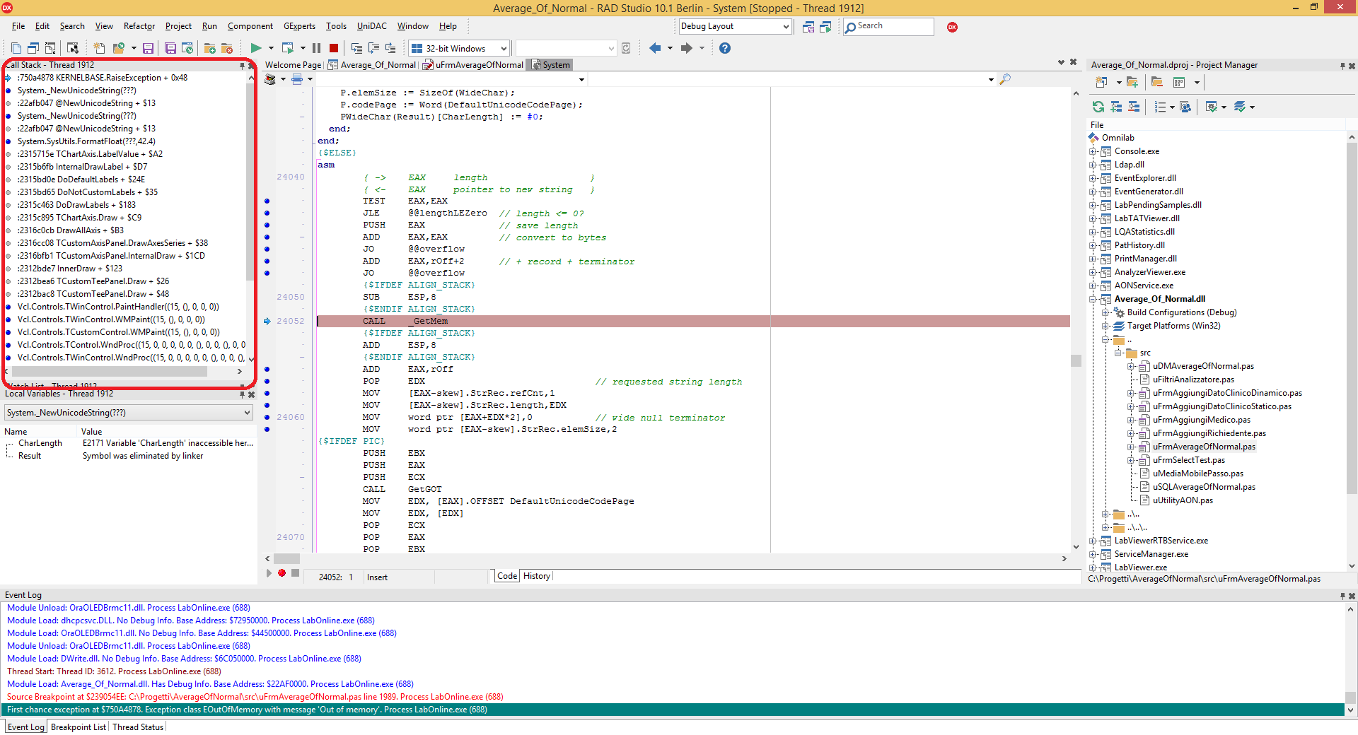

I've made a porting of one of my dll modules that uses TeeChart. The version is 2016.19.
I've the same module running without problem in XE2 environment with TeeChart 2012.
When I run my module in debug point it give me an Out Of Memory error with the Stack Trace in the attached picture.
What can be?

There could be some memory leak.
Could you please try to arrange a simple example project we can run as-is to reproduce the problem here? Of course it would be out of your library, just using a TChart in a form.
