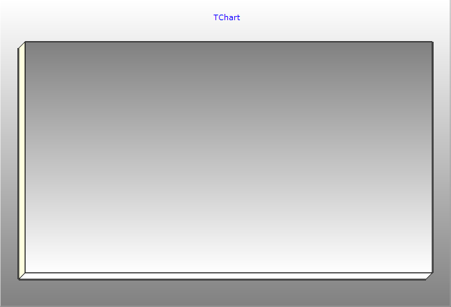

If I drop a TChart into a new Form and I put this code at OnCreate:
  Chart1.Gradient.StartColor:=clWhite;
  Chart1.Gradient.EndColor:=clDkGray;
  Chart1.Gradient.MidColor:=clNone;
  Chart1.Walls.Back.Gradient.StartColor:=clDkGray;
  Chart1.Walls.Back.Gradient.EndColor:=clWhite;
I get this with the current TeeChart v2017.21:
So the gradients seem to work fine for me here with the latest version.
