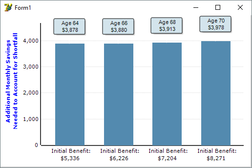

In a chart I am creating I have labels that are put with some descriptive text at the bottom of a chart:
The problem is when I make the chart just a little narrower, even though there is plenty of room, a label gets dropped (notice the label under the 4th bar).
Is there any way to modify the margin each label requires? I need to have the labels display.

Hello Ed,
I've tried to reproduce the problem with the following code and TeeChart v2017.21 but it seems to work fine for me here:
uses Series;
const
  initialBenefit : array[0..3] of double = (5336,6226,7204,8271);
  Chart1.Align:=alClient;
  Chart1.View3D:=False;
  Chart1.Legend.Visible:=False;
  Chart1.Walls.Visible:=False;
  Chart1.Color:=clWhite;
  Chart1.Title.Visible:=False;
  Chart1.MarginTop:=5;
  Chart1.MarginLeft:=5;
  Chart1.Axes.Left.Increment:=1000;
  Chart1.Axes.Left.Ticks.Visible:=False;
  Chart1.Axes.Left.MinorTicks.Visible:=False;
  Chart1.Axes.Left.Grid.Style:=psDot;
  Chart1.Axes.Left.Title.Text:='Additional Monthly Savings'+sLineBreak+'Needed to Account for Shortfall';
  Chart1.Axes.Left.Title.Font.Color:=clBlue;
  Chart1.Axes.Left.Title.Font.Style:=[fsBold];
  Chart1.Axes.Bottom.Ticks.Visible:=False;
  Chart1.Axes.Bottom.MinorTicks.Visible:=False;
  Chart1.Axes.Bottom.Grid.Visible:=False;
    Color:=RGB(83,138,175);
    Pen.Visible:=False;
    Marks.Color:=RGB(211,228,236);
    AddBar(3878, 'Age 64', clTeeColor);
    AddBar(3880, 'Age 66', clTeeColor);
    AddBar(3913, 'Age 68', clTeeColor);
    AddBar(3978, 'Age 70', clTeeColor);
    OnGetMarkText:=SeriesGetMarkText;
  Self.Width:=530;
  Self.Height:=350;
procedure TForm1.SeriesGetMarkText(Sender: TChartSeries; ValueIndex: Integer; var MarkText: String);
  if Assigned(Sender) and (ValueIndex>-1) and (ValueIndex<Sender.Count) then
     MarkText:=MarkText+sLineBreak+FormatFloat('$#,##0.##',Sender.YValue[ValueIndex]);
procedure TForm1.Chart1GetAxisLabel(Sender: TChartAxis;
  Series: TChartSeries; ValueIndex: Integer; var LabelText: String);
  if (Sender=Chart1.Axes.Bottom) and (ValueIndex>-1) and (ValueIndex<SizeOf(initialBenefit)) then
    LabelText:='Initial Benefit:'+sLineBreak+FormatFloat('$#,##0.##',initialBenefit[ValueIndex]);
