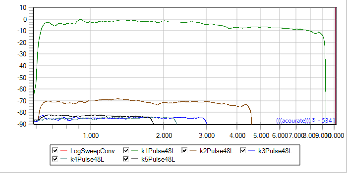

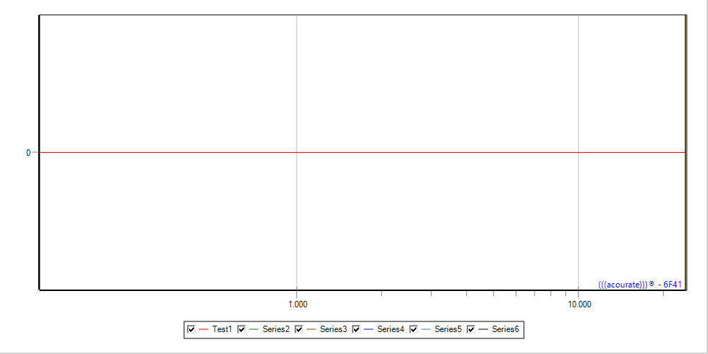

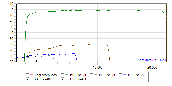

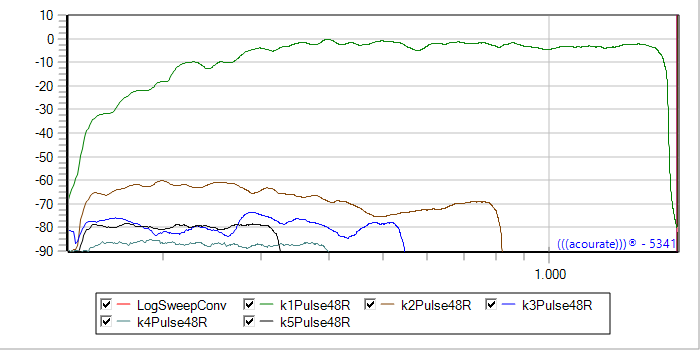

Post by UliBru » Wed Jun 14, 2017 9:21 am
Hello Yeray,
I have done some further tests.
The devil is given by Chart.BottomAxis.Increment. By default the value is 0 and we get x axis labels at positions 1, 10, 100, 1000 ...
If the value is changed to 1 then we get x axis labes at 1000, 2000, 3000 ... But if the chart is zoomed the labels can overlap.
Dragging a window corner to resize the window even shows up the x axis labels jumping between different visualizations.
So a solution is to always use Chart.BottomAxis.Increment := 0. As this is a default value where it makes sense to NEVER TOUCH it!
Now I have still one question (based on a minor tick number of 8):
Is it possible to create x axis labes e.g. in sequence 1, 5, 10, 50, 100, 500, 1000, 5000, 10000 ... ??
And finally there is still a bug with zoom:
So if you e.g. create a chart with logarithmic x axis from 1 to 10000 and you zoom into the chart from 150 to 10000 the minor ticks below 1000 get lost.
See the picture, where 8 minor ticks are missed. So there is no chance to estimate the x axis position according to a given curve point:
Best regards
Uli

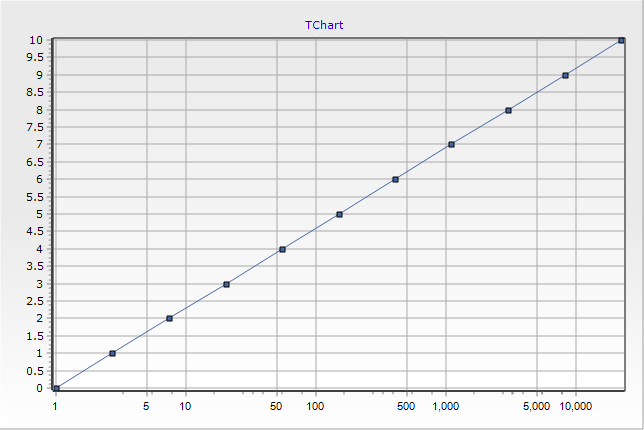

after struggling around with switching linear and logarithmic x-axis including zooming I have now come to the following solution:
var
  i, j: integer;
  maxx, minx, Position: Double;
  Chart: TChart;
  Chart := TChart(Sender);
  maxx := Chart.BottomAxis.Maximum;
  minx := Chart.BottomAxis.Minimum;
  if maxx = minx then
    exit;
  if Chart.BottomAxis.Logarithmic then
    for i := -1 to 5 do
      for j := 2 to 9 do
        Position := Power(10, i) * j;
        if (Position >= minx) and (Position <= maxx) then
          DrawMinorTick(Chart, Power(10, i) * j);
procedure TForm1.Chart1BeforeDrawAxes(Sender: TObject);
var
  i: integer;
  maxx, minx: Double;
  Chart: TChart;
  if maxx = minx then
    exit;
  Chart.Axes.Bottom.Items.Clear;
    Chart.BottomAxis.MinorTickCount := 0;
    if (minx > 0.1) and (maxx < 1) or (minx > 1) and (maxx < 10) or (minx > 10) and (maxx < 100) or (minx > 100) and
      (maxx < 1000) or (minx > 1000) and (maxx < 10000) or (minx > 10000) and (maxx < 100000) or (minx > 100000) and
      (maxx < 1000000) then
      Chart.Axes.Bottom.Items.Add(minx, Format('%1.0f', [minx]));
      Chart.Axes.Bottom.Items.Add(maxx, Format('%1.0f', [maxx]));
    end
      for i := -1 to 5 do
        Chart.Axes.Bottom.Items.Add(Power(10, i), Format('%1.0f', [Power(10, i)]));
//        Chart.Axes.Bottom.Items.Add(Power(10, i) * 5, Format('%1.0f', [Power(10, i) * 5]));
      if (minx <> 0.1) and (minx <> 1) and (minx <> 10) and (minx <> 100) and (minx <> 1000) and (minx <> 10000) and
        (minx <> 100000) then
      if (maxx <> 0.1) and (maxx <> 1) and (maxx <> 10) and (maxx <> 100) and (maxx <> 1000) and (maxx <> 10000) and
        (maxx <> 100000) then
  end
  else // linear axis
    Chart.Axes.Bottom.Items.Automatic := true;
    Chart.BottomAxis.MinorTickCount := 3;
So the solution shows the labels in Power10 steps. If you zoom in and a power10 label is still there it will be shown. In addition the chart now also displays the lowest and highest x value. So if you zoom more into the chart at least min and max x value are displayed as label.
Furthermore the minor ticks are custom drawn and thus are correct for each zoom state. The reported bug is at least also solved by this approach.
Also the export e.g. to PNG now properly works.
So maybe you can benefit a little from my example.
Best regards
Uli
