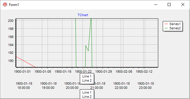

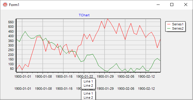

Incorrect axis area size (height) when title using html (Build 2017.22.170619)
Here Is a simple example
__fastcall TForm1::TForm1(TComponent* Owner)
	: TForm(Owner)
	Chart1->View3D = false;
	TLineSeries* pTLineSeries1 = new TLineSeries(Chart1);
	Chart1->AddSeries(pTLineSeries1);
	pTLineSeries1->FillSampleValues(50);
	pTLineSeries1->XValues->DateTime=true;
	Chart1->BottomAxis->Title->Text = "Line 1<BR>Line 2";
	Chart1->BottomAxis->Title->TextFormat = ttfHtml;
	Chart1->BottomAxis->Title->Transparent = false;
	Chart1->BottomAxis->Title->Angle = 0;
	Chart1->BottomAxis->DateTimeFormat = "c";
	Chart1->BottomAxis->LabelsMultiLine = true;
	Chart1->BottomAxis->ExactDateTime = true;
	Chart1->BottomAxis->Increment = DateTimeStep[dtFifteenMinutes];
	Chart1->BottomAxis->ResizeChart = true;
	TChartAxis* pTChartAxis = Chart1->CustomAxes->Add();
	pTChartAxis->Horizontal = true;
	pTChartAxis->Title->Text = "Line 1<BR>Line 2";
	pTChartAxis->Title->TextFormat = ttfHtml;
	pTChartAxis->Title->Transparent = false;
	pTChartAxis->Title->Angle = 0;
	pTChartAxis->DateTimeFormat = "c";
	pTChartAxis->LabelsMultiLine = true;
	pTChartAxis->ExactDateTime = true;
	pTChartAxis->Increment = DateTimeStep[dtFifteenMinutes];
	pTChartAxis->ResizeChart = true;
	TLineSeries* pTLineSeries2 = new TLineSeries(Chart1);
	Chart1->AddSeries(pTLineSeries2);
	pTLineSeries2->FillSampleValues(50);
	pTLineSeries2->XValues->DateTime=true;
	pTLineSeries2->HorizAxis = aCustomHorizAxis;
	pTLineSeries2->CustomHorizAxis = pTChartAxis;
View before zoom
View after zoom
