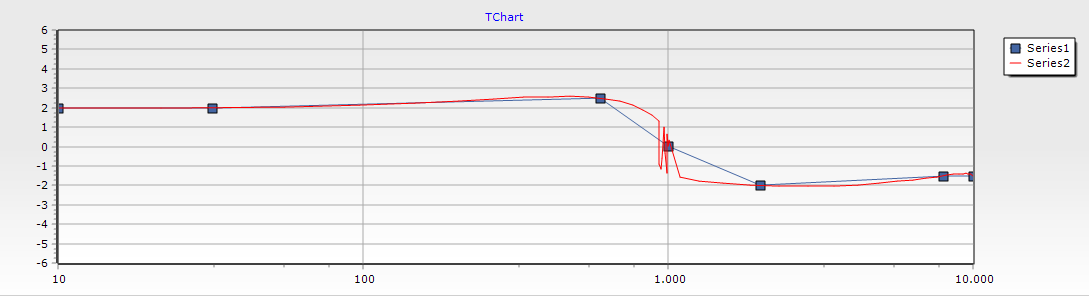

I have the following simple code based on a chart with two line series:
  Chart1.BottomAxis.Logarithmic := true;
  Chart1.BottomAxis.Automatic := false;
  Chart1.BottomAxis.Maximum := 10000;
  Chart1.BottomAxis.Minimum := 10;
  Chart1.LeftAxis.Maximum := 6;
  Chart1.LeftAxis.Minimum := -6;
  Series1.Pointer.Visible := true;
  Series2.DataSource := Series1;
  Series2.Color := clRed;
  Series1.Clear;
  Series1.AddXY(10,2,'',clTeeColor);
  Series1.AddXY(32,2,'',clTeeColor);
  Series1.AddXY(600,2.5,'',clTeeColor);
  Series1.AddXY(1000,0,'',clTeeColor);
  Series1.AddXY(2000,-2,'',clTeeColor);
  Series1.AddXY(8000,-1.5,'',clTeeColor);
  Series1.AddXY(10000,-1.5,'',clTeeColor);
  Series2.CheckDataSource;
  Series2.Smoothed := true;
The target is to get a smooth Series2 through the data points given by Series1.
But it does not look smooth at all:
Without interpolation the curve is smooth but is does not go thru the points.
How to fix it?
BR
Uli
PS: using TSmoothingFunction leads to the same result

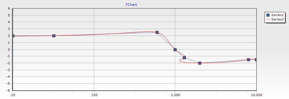

But adding e.g. another point by
  Series1.AddXY(1300,-1.2,'',clTeeColor);
between X=1000 and X=2000 (is ascending X sequence) creates a picture like
So the smoothing seems to have some tendency for oscillations.
BR
Uli

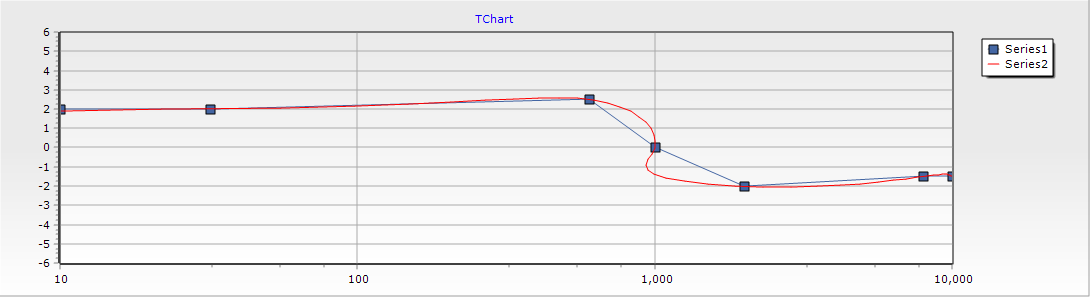

Posts: 9562
Re: How to create a real smooth curve?
Post by Yeray » Wed Jul 12, 2017 7:57 am
Hello Uli,
UliBru wrote:THorizLineSeries seems not to work properly.
This is what I get with TeeChart v2017.22 and the code below:
uses Series;
var Series1, Series2: THorizLineSeries;
  Chart1.View3D:=False;
  Series1:=Chart1.AddSeries(THorizLineSeries) as THorizLineSeries;
  Series2:=Chart1.AddSeries(THorizLineSeries) as THorizLineSeries;
  Chart1.Axes.Bottom.Logarithmic := true;
  Chart1.Axes.Bottom.SetMinMax(10, 10000);
  Chart1.Axes.Left.SetMinMax(-6, 6);
  Series1.Clear;
UliBru wrote:
  Series2.XValues.Order:=loNone;
  Series2.HasZValues:=True;
seems to work.
I'm not sure why this is happening but it seems the BSpline is giving a different result when using those series values and when transforming those values to screen pixels.

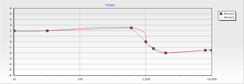

You can use the TBSpline as follows to use pixel values, transform the result back to axis values to add them into Series2:
uses Series, TeeSpLine;
var Series1, Series2: TLineSeries;
var BSpline : TBSpline;
    i: Integer;
    ParameterValue : single;
    V       : TVertex;
  Series1:=Chart1.AddSeries(TLineSeries) as TLineSeries;
  Series2:=Chart1.AddSeries(TLineSeries) as TLineSeries;
  Chart1.Draw;
  BSpline:=TBSpline.Create;
  for i:=0 to Series1.Count-1 do
    BSpline.AddPoint(Series1.CalcXPos(i), Series1.CalcYPos(i));
  BSpline.Interpolated:=True;
  BSpline.Fragments:=64;
  Series2.Color:=clRed;
  For i:=0 to BSpline.Fragments do
    ParameterValue:=(i/BSpline.Fragments);
    V:=BSpline.Value(ParameterValue);
    with Series2 do
      AddXY(GetHorizAxis.CalcPosPoint(Round(V.X)),GetVertAxis.CalcPosPoint(Round(V.Y)));
end;;

Posts: 9562
Post by Yeray » Wed Jul 12, 2017 8:38 am
Hello Uli,
Note I've just edited my last post to calculate the spline at OnCreate and use the output in Series2 instead of having to recalculate it at every repaint at OnAfterDraw event.
