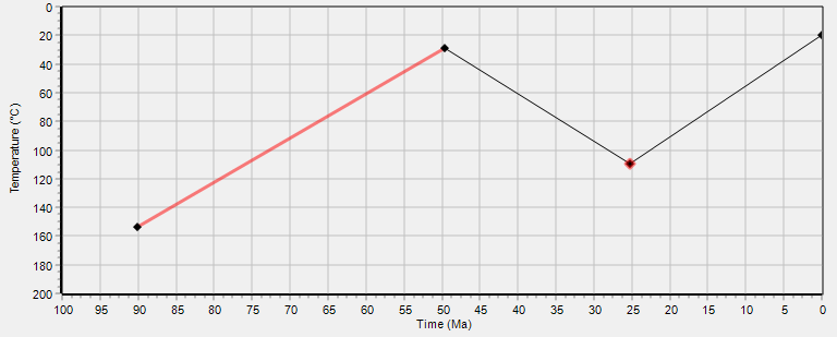

I get strange hovering behavior with a simple TLineSeries in VCL. In this example, my cursor is over the third point in the line, which is highlighted correctly, but only the first segment (connection between two points) is highlighted. The highlighted segment is always one behind the point being hovered on; if I highlight the fourth (rightmost) point, the second segment is highlighted. Is this supposed to happen? I would like to turn off the segment highlighting while keeping the point highlighting, but I cannot find a way to do it.

arekay wrote:I get strange hovering behavior with a simple TLineSeries in VCL. In this example, my cursor is over the third point in the line, which is highlighted correctly, but only the first segment (connection between two points) is highlighted. The highlighted segment is always one behind the point being hovered on; if I highlight the fourth (rightmost) point, the second segment is highlighted. Is this supposed to happen?
It seems to work fine for me with TeeChart Pro v2017.22. What version are you using?

It looks like the problem arises because the bottom axis is inverted. The code below shows this in 2D; 3D behavior is even more bizarre-looking. It appears that nobody implemented counting backwards for hovering.
