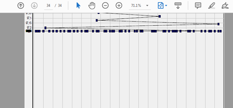

Re: Very long canvas - print fail
Thanks for your reply Yeray.
Some thing's weird.
When I launch your attachment with Acrobat reader 2020.009.20063 .
The printing looks failed.
Some thing's weird.
Sorry, screen shot forgotten .
- Print.png (16.57 KiB) Viewed 45281 times
I could reproduce that and it seems like a problem with the metafile generation.
This appears to be a size limit for a Windows Metafile of 32767 pixels.
Ref.
https://stackoverflow.com/questions/342 ... -metafiles
If the test is run at 33 pages a metafile of 1036x31317 pixels is created. It appears that one page more tips the file over the size limit.
The metafiles don't seem to have saved correctly in the zip you posted, but we'll take another look at this to see if we can shed any light. With the current version of TeeChart the plot cuts the last data points in the metafile at exactly 32,767 pixels, the known limit for a metafile. The canvas continues to plot gridlines to the required size limit though (33,000+ pixels), that raises suspicions that some other factor is involved. I don't see any obvious cause, the TeeChart code relating to metafile generation hasn't changed for a very long time, but we will go through it again.
Found it. There is a maximum pixel limitation setting in TeeChart, used to control out-of-bound axis calculations, that we'll need to review. It's currently set to $7FFF (decimal 32767).
Whilst we check what to do, if you have the sourcecode version you can modify it as an interim workaround:
ie.
TeEngine.pas
In the initialization section at the end of the unit:
change to: (for example)
We'll probably need to change this to an accessible variable so that it can adjust to unusual circumstances such as the case here in hand.
I've moved the
I've moved the
TeeMaxPixelPos
variable to interface
section so from the next version you'd be able to set it as follows:
VCLTee.TeEngine.TeeMaxPixelPos:=34000;
