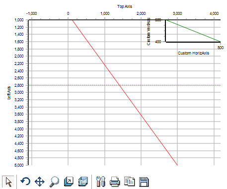

I've added a line of code to clear the series added at design time in your project because they were interfering with the example:
  with TheChart do
      SeriesList.Clear; // Line added
Now the example gives me this result:

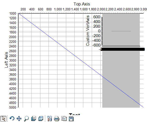

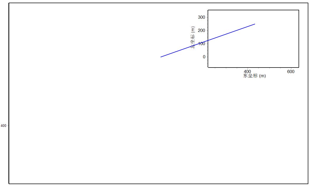

Using the same codes in another program, there are two weird results:
1.Axes Labels do not have the same size (see Fig-1), although I use the same codes to set the Chart and axes properties.
2. When click and zoom in the Sub Chart area, the Curves exceed the range of the Sub Chart area or CustomAxes range (see Fig-2).
